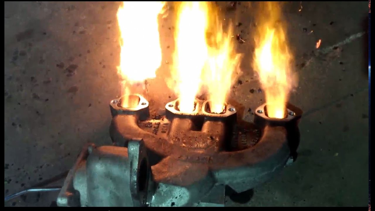

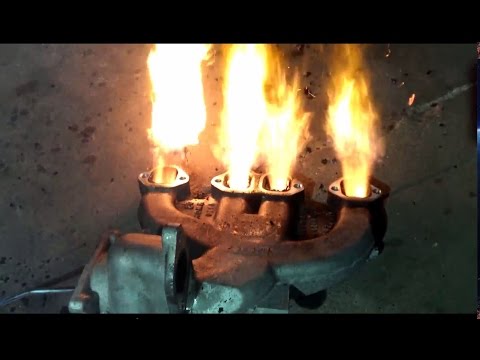

                          • Wingsconsin
                            • 1725
                            • Sussex Wisconsin
                            ... or maybe not ...
                            • Joe Garfield
                              My God... That. Is. Freaking. Cool.
