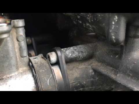

    My problem is that the engine makes a rattling noise when running, which I'm trying to diagnose. From what I've read, it could be the cam chain, primary chain or even perhaps the starter clutch?? It's been a while since I looked around the almighty internet for a solution, so excuse me if I remember incorrectly or I'm saying something else which sounds stupid.
    I've recorded a short video, trying to catch the sound from the engine. It's a little bit tough because of the loud exhaust, but I did the best I could. I'm hoping that someone with better experience could come up with a more qualified guess than me.

    My guess is cam chain noise. Does your cam chain tensioner have the cross wedge w/spring cap or does the bike use the earlier type? Either way, I'd verify the tensioner is doing what it should.
    One thing many people don't understand is that the tensioner needs to be removed and/or loosened any time the valve cover is about to be installed. The valve cover has a rub block that depresses the cam chain so if you don't loosen the tensioner installing the cover results in an overly tight chain.

      If it is the cam chain tensioner, at idle it makes a slapping noise. Won't hurt to take the cam chain tesnsioner off and verify its working properly then refit it taking care to follow the correct install procedure. The Z650/750 engine has, as you say a primary chain. I don't know if that has a tensioner...? Also is it a chain drive to the starter or is it gears?

        That makes perfectly good sense, and honestly that's something I haven't thought of when doing the valves. It did sound like this prior to the removal of the valve cover though, but who knows, someone else might have made the same mistake as me. Would a cam chain being too tight be able to produce noises like the ones on my bike?

            An overly tight cam chain won't cause the noise, but if someone installed the valve cover before releasing the tensioner they may have over tensioned the cam chain and wound up breaking one of the tensioner shoes/guides.
            The primary chain does not have a tensioner. The chain typically lasts the life of the engine though.
            The starter clutch is located on what's called the secondary shaft. The secondary shaft is driven by the primary chain, and then a gear between the secondary shaft and the clutch transfers power to the transmission.

                Went to have a look at the bike today. I have the manual cam chain tensioner. So theoretically it shouldn't be subject to the over tightened cam chain, correct? It's locked into place so it doesn't pick up the slack created by removing the valve cover?
                Anyway, removed the tensioner and inspected it, it seems to work as it should. Reinstalled it per the factory service manual and I could hear it "pop" into place. Is it possible that it's still the tensioner being at fault? Could the spring be too weak to keep the chain as tight as it should? Or what would you suggest to do from here on?

                  If the tensioner springs out like it should then the issue is likely something else.

                    And does the noise sound any different? It is difficult to diagnose a possible fault by third party descriptions of a noise...

                      But you would still suspect that it's the cam chain, even though the tensioner is working?

                        Noise seems to be exactly the same, so as it sounds in the video

                          on the video, the sound seems to be louder on the rh side of the bike.
                          Could it be behind the clutch cover ?
                          Have you tried to locate the sound by using a large screwdriver, one end
                          to the ear, the other end to different places on the engine ?

                            Haven't tried locating it with the method you mention. I did however try running the engine with the oil cap off, which didn't enhance the noise. So I'm thinking not the clutch?

                              agreed, probably not the clutch then
