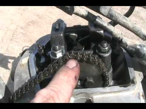

            like this one, for a GSX1300.
            these vids give an idea of how to use the tools and how to change the chain with the engine intact.
            It's how i do it for the GS1000, even using an endless chain because it's so simple to do this way.
            Rijk
