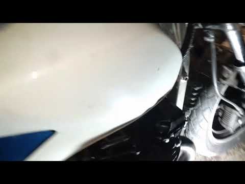

    Heres a quick video of it and trying to find the oil leak / listening for the tick.

    On vidio I could not really see about the "exhaust header" oil leak, and I am not that familiar with the 550s. But on most GS 4 cyclinders, an oil leak in that general area (front, center, upper) could be more from the tachometer drive (if it has such for a mechanical tachometer).

      EDIT- looks cold there already. Your video goes over the trouble spots a little too quickly to focus on any one area. Is that exhaust we're seeing, or oil-smoke from the leak?
        Cool. I will probably replace the crush washer and go from there. I think the cam tensioner has a tiny leak, but not enough to leave a pool of oil on the back side of the motor. As for the front, I have an electric tach, so there is no mechanical tach to leak. I apologize about the video, I was focusing more on the tick than the oil leaks. After I replace the crush washers and valve cover gasket, I will probably degrease it and use some foot powder to try and locate the oil leak. The smoke is from it leaking (I hope). It's was in the 70's in the video. I have an eerie feeling that I may have to replace the head gasket (whats a base gasket?).
