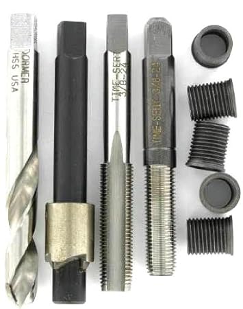

It's hard to tell but that looks like one of those solid inserts like being sold at auto parts stores.
A Timesert is sort of similar except they are mechanically locked into the head using a setting/expansion tool during install.
At this point I think you will have to get that insert off the plug and reinstall it into the head. I'd use something like high temp retaining strength threadlocker. Or, see if you can find someone with a timesert tool and have one of those installed instead. Problem you may have is that the hole is larger now, so you gotta find a large size insert. A helicoil is off the table at this point.

Bad idea. Get a proper spark plug insert like the Timesert. The more you monkey with the hole and make it larger the bigger job it's going to be for the machine shop to fix it right.Originally posted by Blue Falcon View PostCylinder head side plug...... checking our autoshop to see if the have a 3/4-16 tap. The plan is to tap it out, use a smaller helicoil wire, heat up the helicoil wire wrap it around the insert pop some green loctite on it and see if it sticks to the wall until I get a new head.

Its going to the machine shop on Monday, 99% chance same day fix and the do it in place. No need to pull the head. “Cylinder head specialists”. According to them, it’s a very common problem on aluminum heads.Originally posted by Nessism View PostBad idea. Get a proper spark plug insert like the Timesert. The more you monkey with the hole and make it larger the bigger job it's going to be for the machine shop to fix it right.
