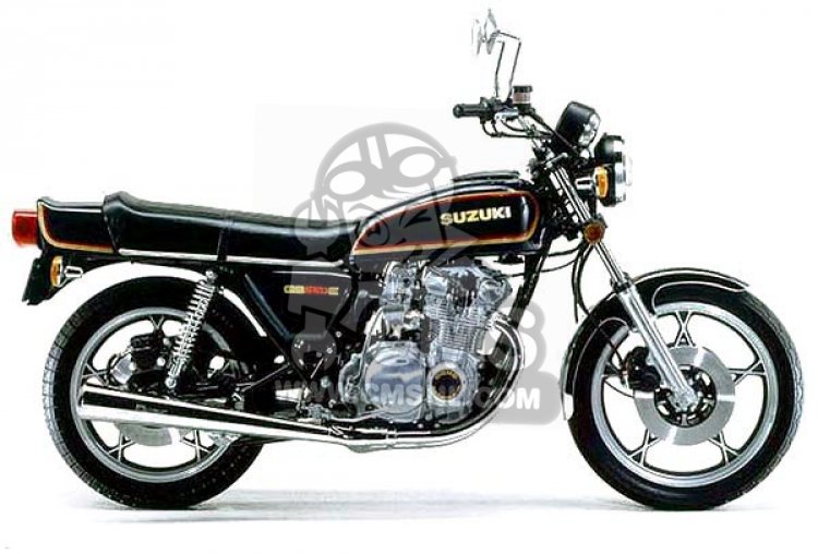

I go here to find official suzuki #. I always take it with me to the local store.
✓ Suzuki spare parts for GS550 Motorcycle. ✓ Swift delivery ✓ Original Suzuki GS550 parts
✓ Good to order: SPROCKET,REAR ✓ Manufacturer Part Number: 64511-47001 ✓ OEM Suzuki part
