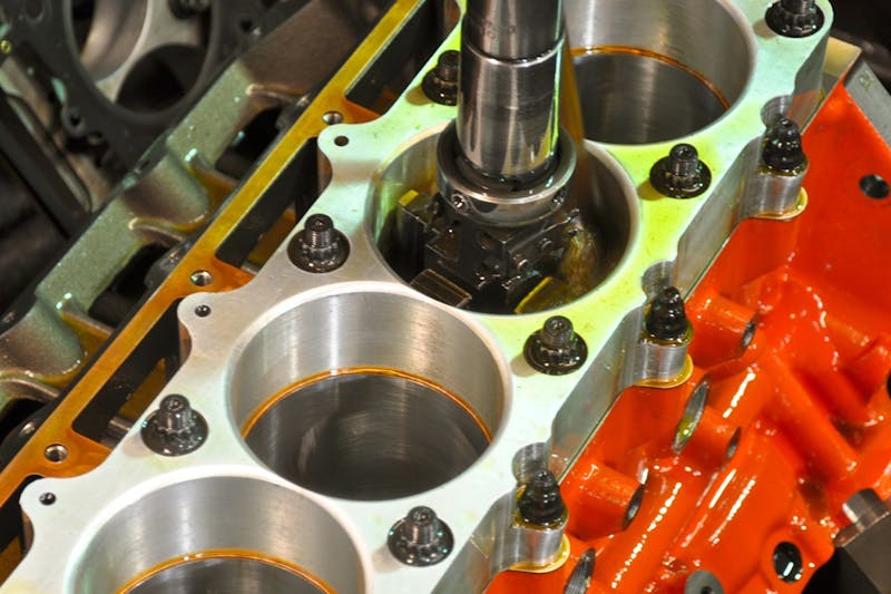

              gfpunto, I have to disagree with Steve, synth is too slick and will not allow the rings and the cross hatch hone to rub each other to seat the rings properly. Do a Google search on using synthetic oil during ring seating and see what the expert engine builders have to say. They do this for a living and have reputations to uphold. We were told at MMI by multiple instructors from different manufactures, to never use synth during the break in period. You can use straight conventional oil, but adding some with extra zinc helps as long as you don't go overboard with the zinc. At the shop I work at, I don't have oil with extra zinc, so I just use conventional 10-40 and haven't had a problem yet. Since you have already coated the cylinder walls with the synthetic oil, if you don't want to tear down the engine and re hone the cylinder walls, I'd ad a quart of oil with extra zinc. Here is a good article you may want to read, but I recommend doing more research and see what others say such a piston and ring manufactures and engine builders suggest.
              Engine break-in is one of the most widely misunderstood processes in the automotive world. High Performance Academy seeks to change that.
