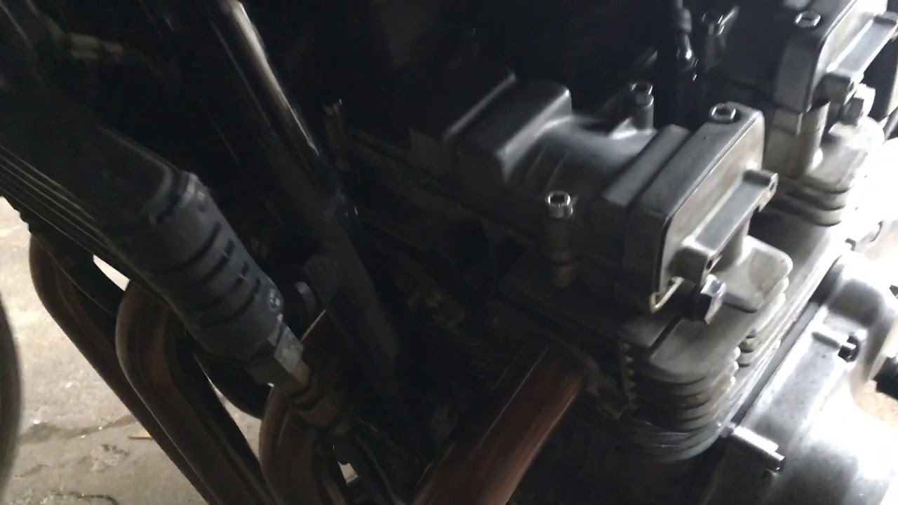

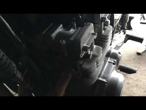

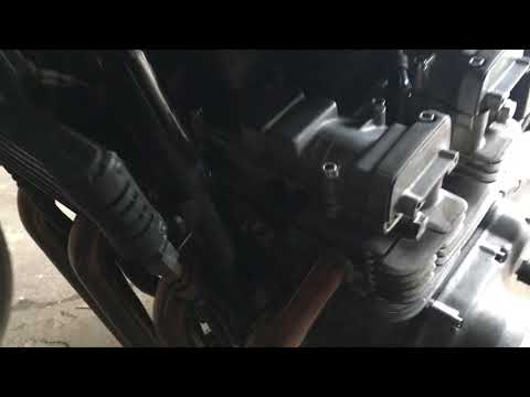

                          the tapping persists. i made a pair of videos to demonstrate the sound.
                          1) this video shows the engine idling, and i move the camera around the engine to show how the sound is localized to the cylinder one top end, near the valve train.
                          2) the second video is showing how the tapping responds to throttle. some throttle blips, and some slow roll-ons.
                          i know it's a vague assumption, but it sounds like maybe a spring is "lazy" somewhere in the valve train???? not even sure what i mean by that.
                            maybe a sticky valve might give that sound? ie: delayed release so it taps the cam instead of "following" it perfectly
                            a link
                            An engine valve works in an intense environment, traveling up and down dozens of times per second in a gaseous atmosphere hot enough to auto-ignite pine wood. The valve slides up and down inside a cylinder head's valve guides with no more than a human hair's worth of clearance. Over time, carbon deposits and ...
                              • 4613
                              Sounds like a exhaust leak. Or maybe a spark plug backed out...
                                #30
                                That just doesn't sound like a tappet, to loud. Anytime I had a loose one (usually from when I adjust the valves, I always get a ticker) it was very faint. I've never had one ever come loose in 35 years, though I have had to replace a screw adjuster and the jam nut now and then. They become tight in the threads and won't adjust, just pop in a new one and go on.
