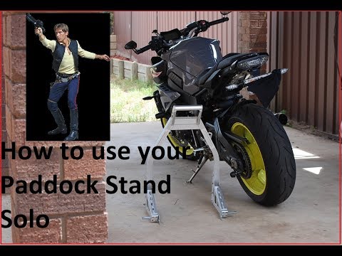

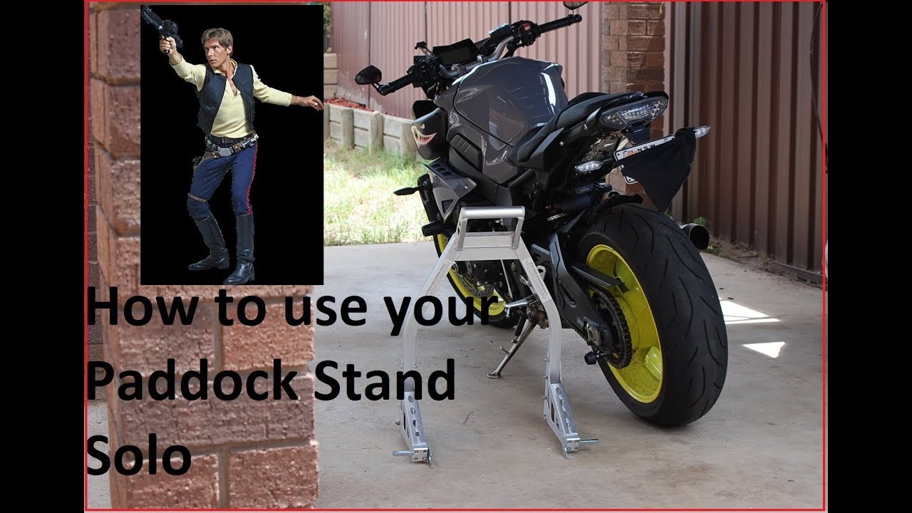

                  lots of videos on youtube. I like this one.
                  all stands are not created equal. here's some reviews and comparisons of stands of various qualities.

                    You can get any bike on a paddock stand alone. With the bike on the kickstand, you put the V shaped lifter of the stand on the sprocket side spool, stand the bike up, put the V lifter of the stand under the brake side spool, then push down on the handle of the stand and voila! rear tire is in the air.
                    When shopping for a paddock stand, I highly recommend the spool type as they are MUCH more stable and secure than they type with L shape lifters that go under the swingarm. You'll need to bolt on some spools onto the lugs of your swingarm.
                    Pitbull makes some of the best paddock stands out there. IMO don't cheap out on a stand because if it bends, fails, or your bike falls off the stand due to poor stand design, you're going to have a very bad day. Pitbull stands are made in the USA, work great, built to last, and the TIG welding on the joints/seams is amazeballs.

                      Without modifying my bike, I had to use the L-shaped lifting pads. Stand was on sale for $19.95 so I couldn't say no. Came with parts for bikes that did and didn't have the "grommets" on the axles.
                      Getting her up is really no problem. Centered, that's another matter.
                      Getting her down is the scariest part. Make sure the side stand is extended. And in my case, aimed for the brick I lean her on.

                        Thanks, I'd never seen it done before. On those videos it sure looks easy. I'd wondered about maybe putting something under the side stand, to hold the bike up, almost straight, then put the paddock under it. I would never try to hold the bike up straight with one hand, while using the paddock lift with the other, nope, I ain't doing it. Just give me the old simple centerstand, never know it's there till you need it, you always have it with you, you never need to find a place to store it, it's easy & simple to use by yourself with confidence, & it only adds maybe 6 or 7 lb. at the very bottom of the center of gravity. I'm fix'in to go look, a couple of yrs. ago, I read there was someone, I think in Europe, that was designing a clamp-on centerstand for the ZRX's. I want one.

                          Forgot to mention, I work completely alone. It's a little easier to start off with a brick under the side stand, but that's how I park mine anyway. I think it used to stand on two bricks before I replaced the front springs.

                            Gets easy with practice.
                            With my Triumph, (no center stand), I stand it up, balance it with my hip, and my left hand on the tail, while using my right hand to slip the stand under the swing arm, and push down.
                            With the kick stand down, if I do start to lose balance, I just use my left hand and hip to lower it on the side stand, which is exactly how I get it off the paddock stand.
