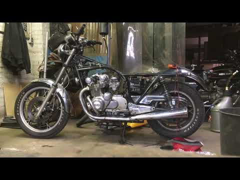

    i got a free project bike a bit ago, and just got it running today.
    clicking through the transmission, and unfortunately there are false neutrals all over the damn place.
    trying to see what my options are, and maybe chronicle my attempt to fix it.
    haven't put it on the road yet for a rolling test, but it shifted very poorly with the engine off and rolling the wheel by hand, as well as on the centerstand and the engine idling. i dont expect a road test to be any better...
    and the first start video, because who doesn't love a first start video??

    You can't test the transmission by shifting without the engine running and the bike stationary. Regarding the engine, the airbox needs to be on for the bike to run decently. Try touching each pipe from a cold start to see if each cylinder is running.
    Oh, and please check the newbie mistakes thread to see if anything applies.

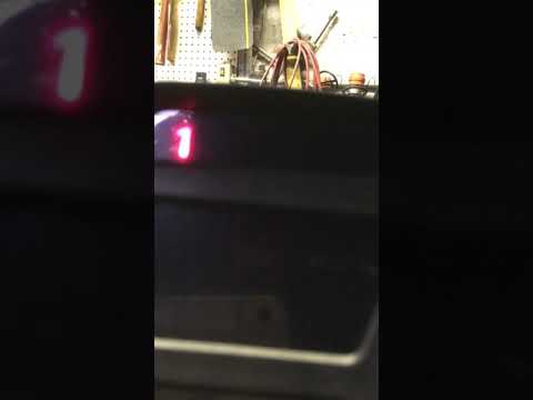

              the transmission still does have issues, though not as dramatic as I had originally felt.
              shifts well up from 1 through 6, but has downshift issues.
              the trans won't let me downshift from 3 to 2. the gear indicator will flash 2 for a second, then when the clutch is released, the trans pops back up into 3. this happens over and over. no terrible noises or anything, but it won't stay in 2nd gear. a double downshift gets you into 1st, and it's fine.
              i assume this is a bent shift fork? not gonna fix it, but i am interested in the cause.

                transmission issues still exist. Lots of false neutrals, and trouble getting it to click into gear and stay there. Once it’s in gear and engaged, it won’t slip out while under load, but sometimes it takes a few tries to upshift into 4th or 5th, and down into 2nd.
                as an experienced owner/rider of $h1t bikes, I have no problems riding it around town and operating it safely, but it’s a different thing for someone who is test riding it. The problem seems worse than it actually is.
                any ideas about oil weight, and how that might help or hurt this issue? It’s got Rotella T6 in there now, 15w40. Try something heavier? Lighter?
