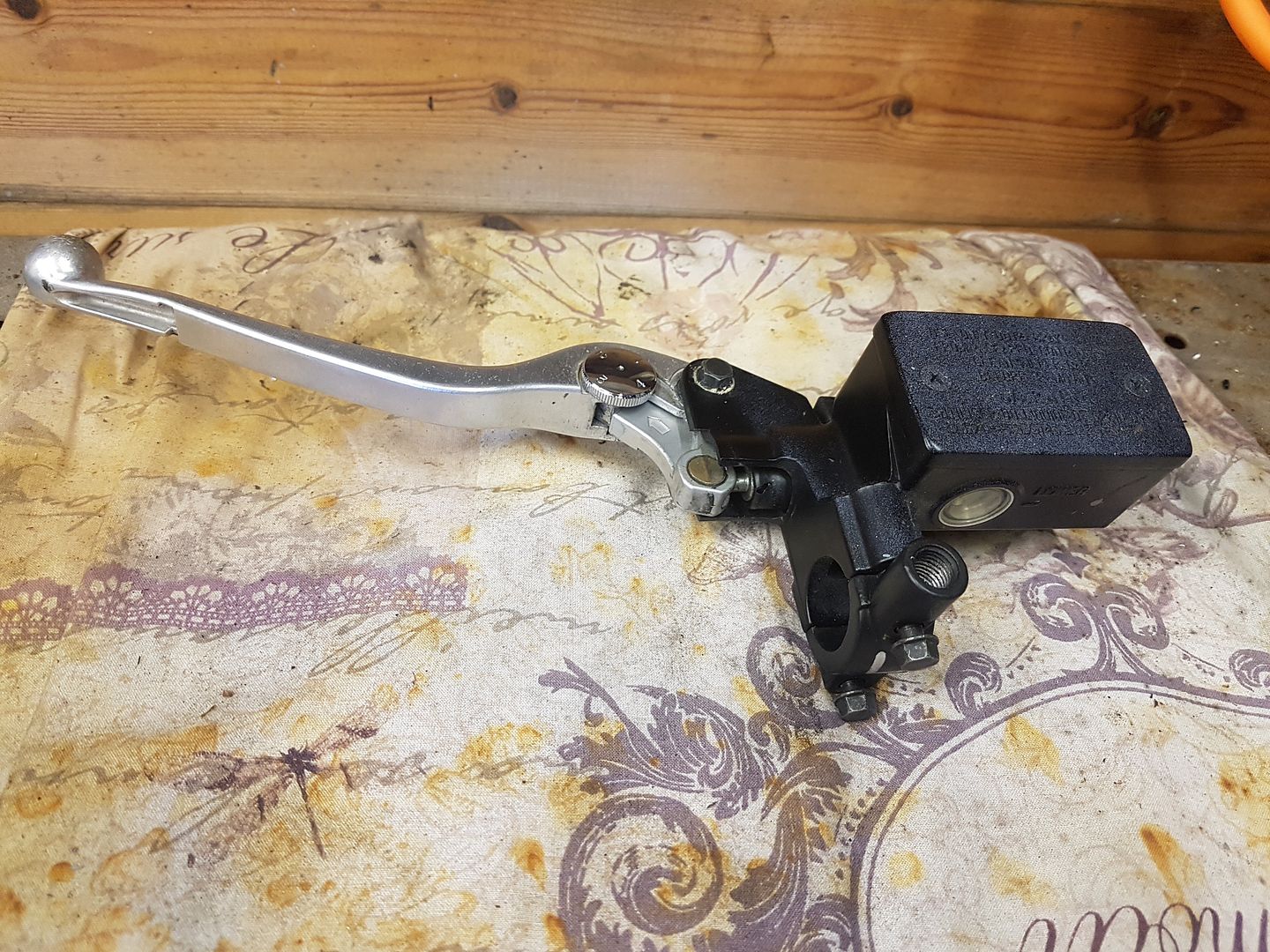

                      I have been mulling this idea over for a number of years but just not got round to it, I have a Suzuki Bandit GSF1200 hydraulic clutch master cylinder (eBay) and a slave cylinder which cost ?85 at a bike show a few years back from Venhil https://www.venhill.co.uk/frando-clu...ong-11nbl.html I just need to measure the size of pipe I need and spend a couple of hours fitting it all up. The slave needs 10mm thow to work with the GS. This thread might get me inspired to start or possibly not..
                      Jeff
                      Living the dream...
                      • bobtail84
                        • 163
                        • Westcliff-on-Sea Essex. UK

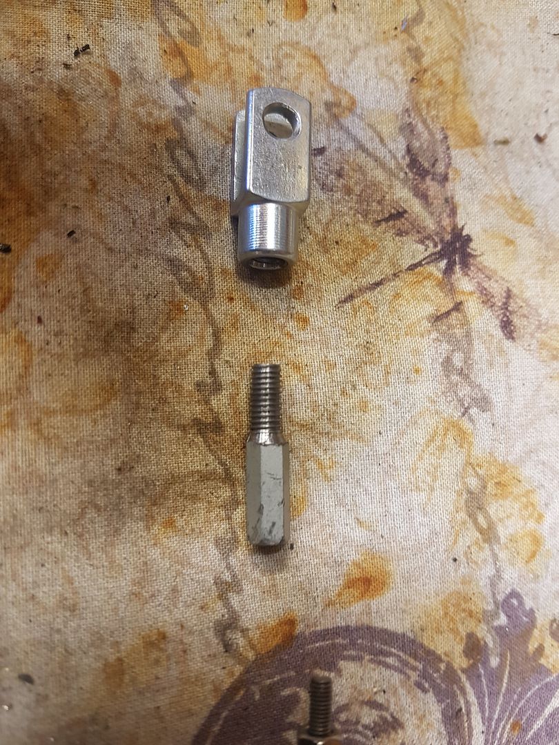

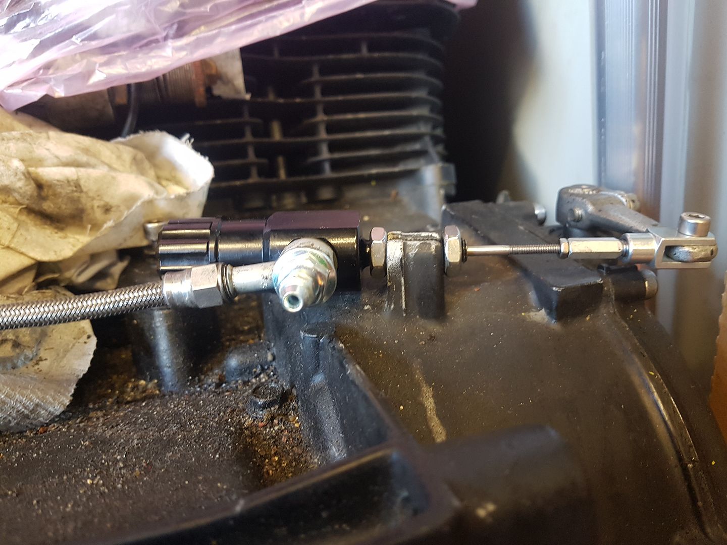

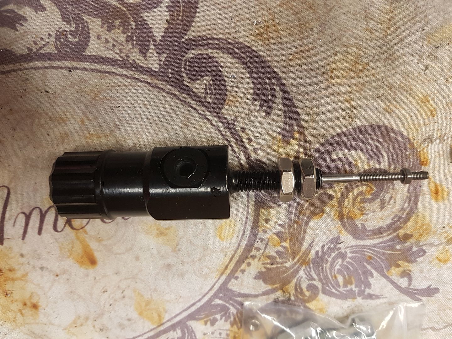

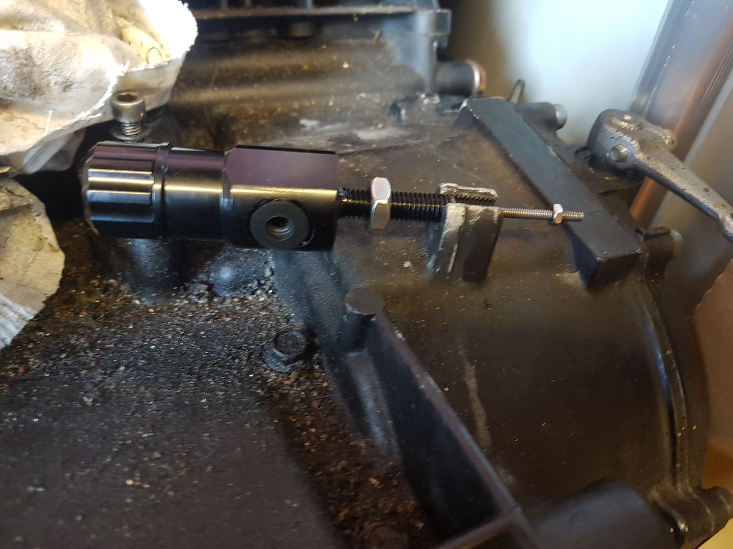

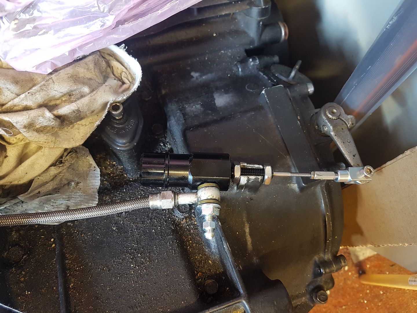

                        I just happend to be down the shed and to add to the comments on this thread I have a little info with pictures and a mock-up of the Hydraulic clutch conversion that is fully reversable and may or maynot work. I have made sure the parts fit on a mill I have on the floor in the shed which is a GS1000 again this is a mock-up and I will no doubt get around to it after I have tried the idea out on the spare engine.
                        I have no particular reason for doing the conversion, it's only because I can and if it works woo hoo and if not I will put the cable back on.
                        Parts.
                        1PC Motorcycle Adjustable Hydraulic Clutch Brake Pump Master Cylinder Rod System Piston diameter: 14mm
                        Note: the piston size of the upper pump matched with the product must be no less than 14mm, and the working stroke shall be no less than 12mm. ?12.44
                        DIN 71752 Clevis Fork End / Rod End Joint Right-Handed Thread M5 x 0.8 Thread Pitch ?2.89
                        Suzuki GSF 1200 bandit 1996-2000 clutch master cylinder ?24.99
                        You can use braided brake line and you will need to measure the length required.
                        The reason I went for this set up was I have read many threads on the conversion and 1 chap on another forum spent the budget of a small south american country and the difference was sod all.. I do not have the spare $$ and I if was going to convert it back due to the idea being not much better than standard I wanted to spend as liitle as possible.
                        The MC was from a GSF1200 Mk1 and comes with or without mirror mounts as required.
                        The slave cylinder has 24mm of thread and 12mm stroke. My GS1000 uses 10mm of travel your may be different.
                        The slave cylinder comes with a hex threaded sleeve which I threaded to 5mm so the clevis fitted.
                        I made sure the slave fitted using the original thread and it does.
                        Then mocked up to see if it fitted.
                        My next job will be to connect the MC, bleed the system and make sure there is enough travel to operate the clutch.
                        As the braided pipe can be run in the most direct route I will look to run it gown the center of the frame and down between the carbs to make the shortest and cleanest run for the pipe but that may change.
                        As I said at the top of my post this is just to see if it works on a reasonable budget and is fully reversable if it's a complete and utter failure which there is a good chance it will be. Both pistons are 14mm and I'm aware there is a whole lot of mathamatical voodoo in regards to displacement and force and stuff and.. well, it's complecated but I thought I would have a go.
                        I will update when I have more info but please let me know what you all think but please bare in mind this idea is just for fun and will probably fall on it's arse.
                        Jeff
                        Living the dream...
