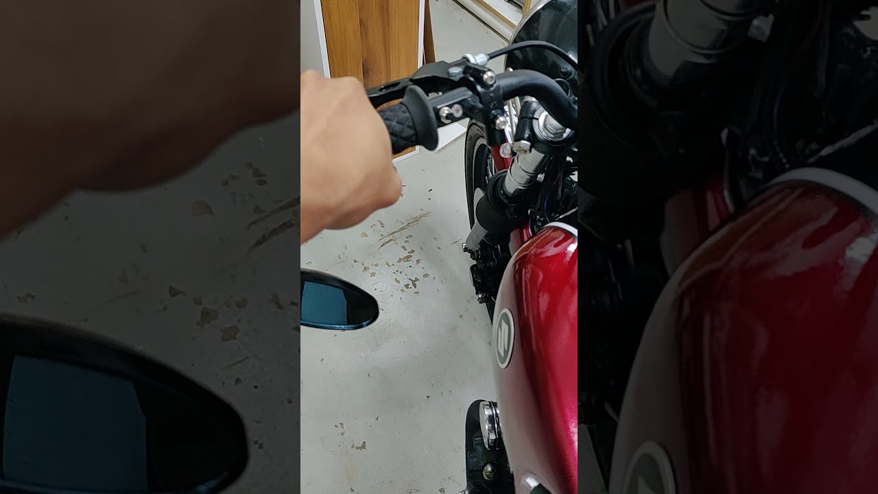

    Hi all, my 1981 GS550T was running perfectly until this morning when a loud constant grinding noise from the engine whenever I go into idle. Some observations
    1. Idle - grinding sound
    2. Idle - pull in clutch . Still grinding sound
    3. First gear clutch pull in - totally no grinding sound
    4. Riding along in with clutch release - grinding sound. Maybe less but I believe it's due to the rpm drive drowning compared to idle.
    5. Sounds like the noise is coming from the transmission area of the engine.
    6. Shifting is fine and no clutch slipping.

    Can listen to the sound here:

                    An update, after last night's clutch basket spring stretching as guided by basscliff and tightening of the clutch basket nut. Seems the grinding noise is gone but I haven't had a chance to do a proper long ride to be sure though. Will keep this thread updated on the progress for others with same issues.\
                    Further update: thus far all is good and the sound is not back. Have no idea what i did. Maybe backing the clutch adjuster rod (the adjustment on the left side of the bike) helps. Im suspecting it could be that. Maybe its the washer between the needle roller bearing at the tip of the clutch push rod worn not evenly causing friction sound when its not pushed on the clutch plate.
