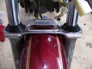

                Well, as the title states.. The Builder has been busy. He actually has the bike all together now, and sent some pictures my way so I figured I'd share them. There is still work to be done, brake lines need installed (calipers and master cylinders need cleaned as well), chain needs installed, exhaust needs securely fastened, and a few other small items. But here are the pictures:
                Front fender installed with fork brace:

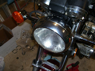

                Front end Headlight and turn signals:

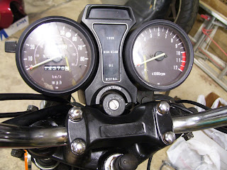

                Guages:
                And here is the bike all together, like I said, the exhaust isn't secured here, but mocked up, and there are some bits that need some attention to detail, cleaned etc, but it's rolling on it's own wheels at the moment:
