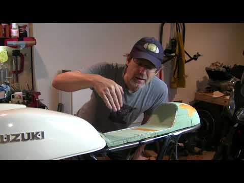

          cman, as Suzukian points out, if you’re so inclined, the seat you have, such as it is, can be made better, but you’ve gotta deconstruct what’s there or use it as a starting point to build upon. Yes, many have made custom caf? seats, chopped frames, cleared out the triangle where the battery and other electrical components once lived, and have done It successfully.
          Urban Monk TV YT channel is just one of many you could study to make a comfy seat. The bike he rebuilt just so happens to be a GS 550, older than yours but essentially the same.I’ll link one of his videos below that details a bit of the seat construction. I watched the whole series over a number of years. Not because I was at all interested in a caf? build, but because I appreciated his demeanor, explanations, attitude, trial and sometimes error method of making the bike the way he wanted it, being thorough on the maintenance items, rebuild everything, paint prep and finishing touches. This guy has the tools and the skills and the patience of Job.
