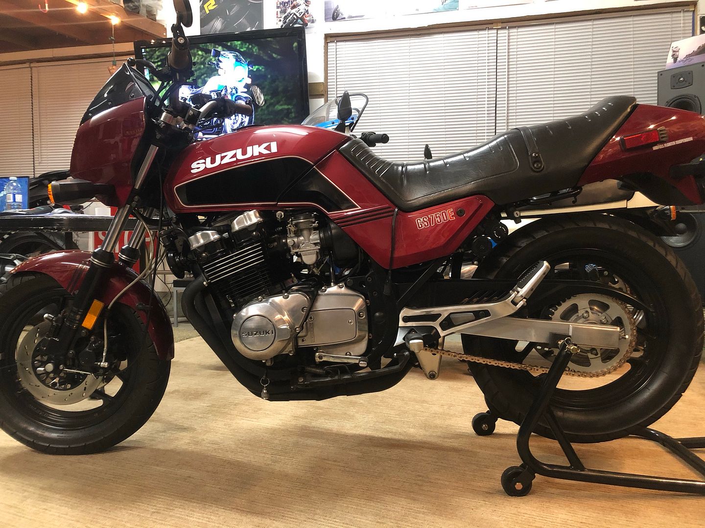

      I've had 2 frames powder coated and I will never paint another one! Paint is easier to fix if you get any chips, but the powder coat doesn't chip as easily! Both of my frames came out a lot glossier than the painted one, but that may depend on what paint is used. And yes, you can forget about the frame label, it will not withstand the heat of powder coating. Of course, paint is a lot cheaper! And yes, you probably will have to clean the powder coat out of the threads, a tap works wonders!

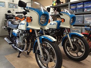

              I have restored several Suzuki Motorcycles including (2) GS1000S's and I used VHT Roll Bar and Chassis Paint (Gloss SP670) on the frames, the finish was about as close to the stock paint as I could get. I was able to sand down an area that was rusted or damaged and do a blend with the new paint and it was virtually impossible to tell from the OEM paint.
              I have had many parts powder coated as well, but prefer to use paint on the frame because of the VIN label as Ed mentioned.
              If you have any questions related to your restoration just ask, there are a few of us on GS Resources that have done a few of these bikes.

                How do you decide which one to ride?
