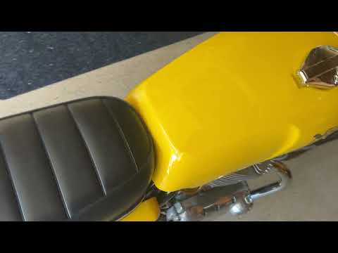

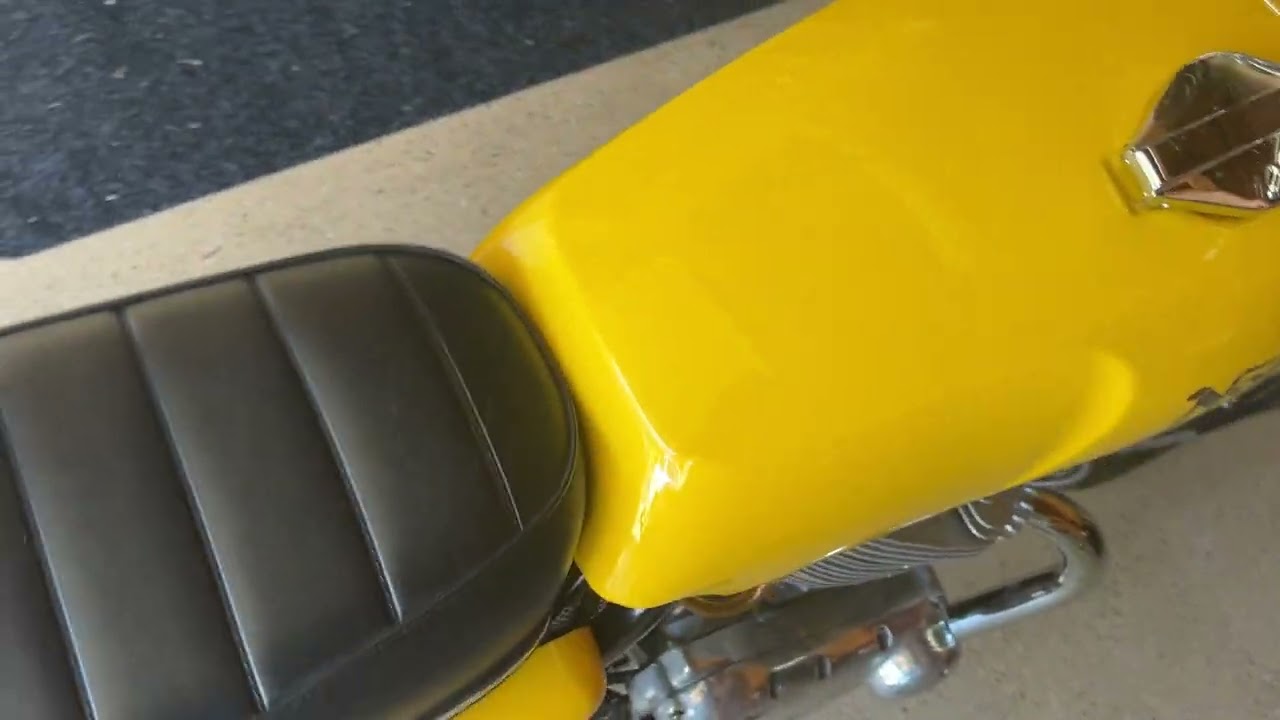

        https://youtube.com/shorts/eOojIOPzb0I
        There's a whiff of smoke out the left pipe on the overrun as you can see in the video.
        It sat a long time. The compression is 187 on each side now, after 100 miles or so, and the smoke has diminished to negligible - but they all smoke a bit. These bikes didn't come with rubber valve seals, but they can be fitted. Maybe they are on this one, I threw some STP in there, and it stopped, so I think so, LOL. My N15CS only has cast iron guides, and there's no smoke at all. I think they are 10K bikes before a refresh.
        Not sure why the video never shows a thumbnail, I select 'video' from the toolbar. I'm a feeb.
