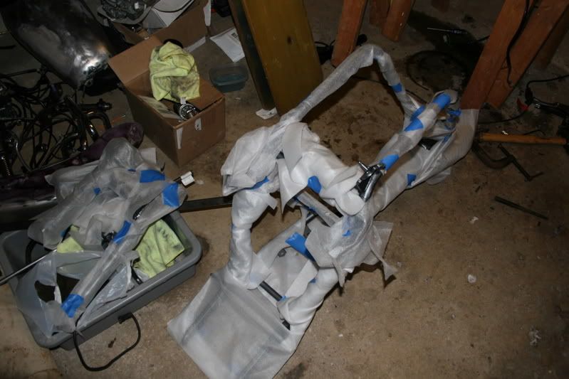

Well, I finally got to my buddies, so I can use his welder. I will be posting a how to article on changing the rear fender soon. Quite a few pics, but I still have one last task to do. Anyway, My Frame has paint! Here are some pics
All Wrapped Up from the painter...Well me, cuz I painted it at my Dad's
Here's the color
