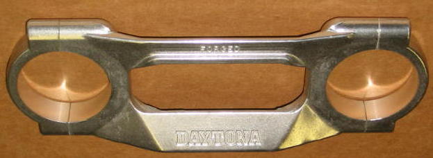

          • oshanac
            Is that an aftermarket fork brace MYSUZYQ?
              Yes, I scored it on ebay a couple years ago, for $30. It was NOS, appears to be similar to these Daytona braces you might find on ebay, once in a while....works well!
              Tony.
