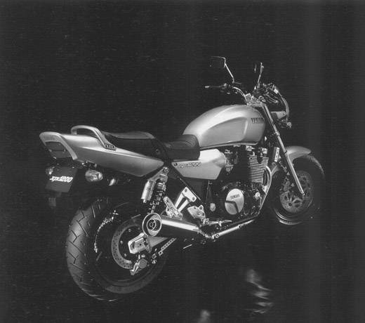

Well, let's just say I got a blooded tooth after helping my dad out with the rebuild of his Yamaha XJR1300 (new running gear).
