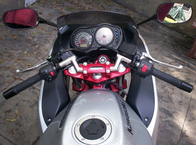

    The real reason for the post: Has anybody ever seen a set of bars like these Don Vesco low bars?
    They look like "Flat" or zero drop Clubmans. I've never seen any like that but I thin they would would work great.

    suburban handlebars look similar. mostly found on newer sport bikes.

      Thanks for the response Crazydave.
      I had never heard of Suburban. Those would work I bet, but at over $170 I will have to pass on new ones. I wonder how hard it would be to find used ones.
      One of the reasons I ride these old bikes is that I'm CHEAP .
