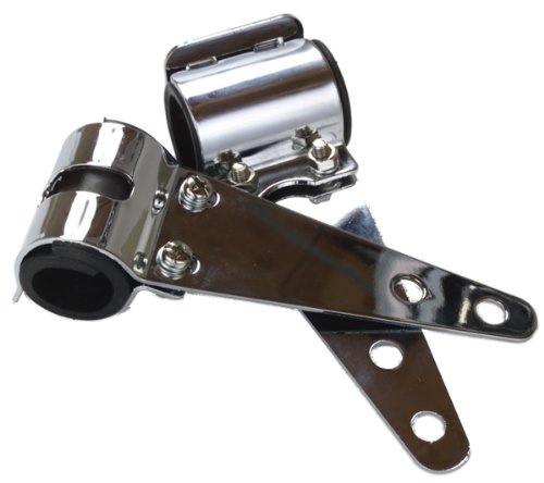

        search for "headlight brackets" on ebay or dimecitycycles for example.

          Click HERE to see the ones from dimecitycycles.
          These appear to be very nice.
          Sorry about the picture size, I just copied from their catalog.
          Click HERE to see the bolt-on universals I mentioned earlier.
