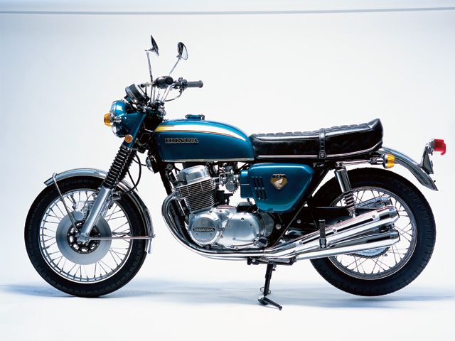

                          Just now caught on to this thread and didn't see any mention about the 70s Honda 750 Four exhaust. Remove the end caps and you have the same thing.

                            #43
                            • wymple
                              • Apr 2014
                              • 1893
                              • SE Iowa
                              #44
                              Never cared for the Honda pipes, don't see much difference. With all that piping, it had to be thin to keep the weight in line and the Honda stuff rotted rather quickly as I recall. My old XS650's had far better stuff on them.
