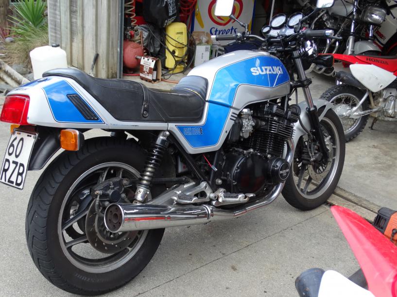

                          This will be a project one day soon..
