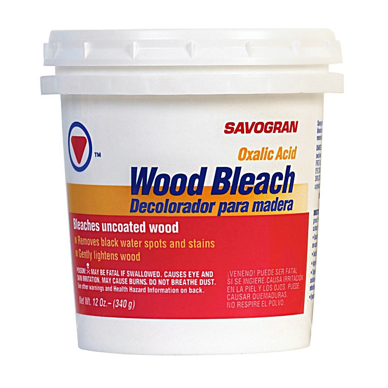

              Aluminum foil WILL scratch chrome. I know this from first hand experience. If the chrome is dulled out and real rusty you may not notice though. If you want a pristine finish when finished, do not use aluminum foil.
              Regular old Turtle Wax chrome cleaner works well. If there is a lot of rust then something to soak the part in is recommended. Navel jelly and the like is phosphoric acid and will eat the rust. It will also pit the chrome slightly too.
              Best stuff I've found that won't hurt the chrome is EvapoRust. It's expensive though. Second best stuff is oxalic acid. Most deck cleaning products are oxalic acid. I was turned on to this stuff by the bicycle restoration guys, who swear by the stuff. Fill a garbage can with water and mix in some of the cleaning product and dunk your part. In a day or two the rust will be gone and the chrome won't be damaged. I've done all kinds of parts in this stuff and it works a treat. Good stuff.

                            Thanks for the tip. I have many chrome parts that need help. Can turn signals be dipped whole?
