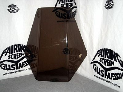

                Thanks Steve...I even found a source for a 4" taller windshield last night, in multiple tints...pricey, but options are a wonderful thing since I'm 6'3".

                    For those reading here's the link to the taller windstar shield-
