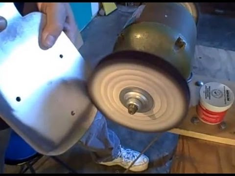

So since I'm on spring break and I can't my tires replaced for like two damn weeks and since I sold my Shadow on Friday i felt i need to be productive in some measure. So naturally the wifes part bike became my test subject. I've never polished aluminum and decided to give it a try. After stopping by Harbor Fright and picking up some cheap wheels and grey and white compound i went to town. How much compound should I use and how do I tell once a wheel is used up? They turn straight black right off the bat and I have no idea what a used up one looks like... Does anyone have any suggestions on how to get the fins relatively easily without breaking out the tiny as brushes? I'm thinking maybe my dremmel? Also, those damn spark plug areas...?That seems hardcore OCD to me though. I'm planning to keep the bike long term so it's going to be slowly overhauled. Next winter I'm planning on tearing it down for painting and redo the wiring.Tags: None -

To address some of your other questions:
- Yes, the wheel will turn black almost instantly.
- How much compound to apply? I have seen some people really goop it on, but I have found that it doesn't take all that much. You do have to load it up a bit on a fresh wheel, but after that, it does not take much at all.
- When is a wheel "used up"? That one is easy. If you are using a bench grinder, you start when an 8" wheel. When it gets down to abut 5", it is hard to get some parts around the wheel without hitting the grinder, so it's "used up". If you are using smaller wheels on a hand drill, good luck. You need a really high-speed drill. I use a Harbor Freight cheapy drill at about 3000 rpm, it does OK to touch up aluminum that has already been polished, but not so good to start from scratch.
The key to polishing is surface speed of the wheel against the work. A smaller wheel needs a higher speed.
One last thing to remember: do not mix different compounds on a wheel. If you start a wheel with gray polish, use ONLY gray polish on that wheel. Get a different wheel for the white polish. The edge of the wheel will turn black on all of them, but you don't want to mix the colors.

For the stuff shown there, I used a spiral-sewn wheel on my bench grinder. I just move the parts around to attack the cracks and crevices from different angles, eventually it looks OK.
For some of the small areas that the large wheel won't reach, I use some small felt bobs in the Dremel, then go over the whole area with the large wheel.

After 5-10min of use any wheel will get black no matter what compound your using....that's just normal. Me, I just run the compound stick across the spinning wheel...use it for 5min, then swipe again. If you over load it you'll get smudge on your work - that's a tell tail sign that you've added too much.So since I'm on spring break and I can't my tires replaced for like two damn weeks and since I sold my Shadow on Friday i felt i need to be productive in some measure. So naturally the wifes part bike became my test subject. I've never polished aluminum and decided to give it a try. After stopping by Harbor Fright and picking up some cheap wheels and grey and white compound i went to town. How much compound should I use and how do I tell once a wheel is used up? They turn straight black right off the bat and I have no idea what a used up one looks like... Does anyone have any suggestions on how to get the fins relatively easily without breaking out the tiny as brushes? I'm thinking maybe my dremmel? Also, those damn spark plug areas...?That seems hardcore OCD to me though. I'm planning to keep the bike long term so it's going to be slowly overhauled. Next winter I'm planning on tearing it down for painting and redo the wiring.
Once you get past the 1sr sewn circle on a sewn wheel...the wheel will get semi loose but that's ok too. It's still sewn on the rest of it but it just won't be as tight as 1st used {mind you, I'm using HF stuff....better grade wheels might be a better experience}.
I can tell you these simple things- 1st, if your gonna be there for a while, get a good working angle - my time is roughly half a day getting a 18" tall brass church candle holder done and it messes with my upper shoulders by the end of the day.
Wear gloves...the metal can get warm when your working it.
Watch your attack angle and swing...nothing worse than a part grabbing the wheel and flying!
As said earlier, mark your wheels per the compound you use with it {I use a permanent marker}.
I'd also add that as your wheels wear, they'll throw a lot of dust and strings at you...and your shop. Where work clothes and a mask wouldn't hurt either so you don't breath all that dust in.Comment
