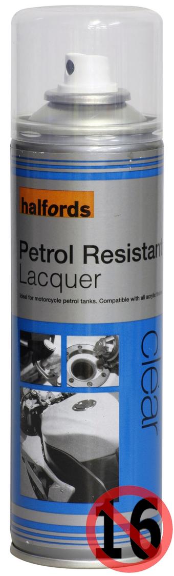

What is your petrol resistant clearcoat? Does it differ from what you used for the drycoat over the decals? Just out of interest
1980 GS1000G - Sold
1978 GS1000E - Finished!
1983 GS750ES Special - Sold
www.parasiticsanalytics.com
Q&A
Clearcoat type:
I use halfords 300ml cans of petrol res clearcoat.
Good quest on the drycoat and over the decals !
- I use normal clearcoat as the drycoat
- I have on this occasion used petrol res clearcoat
over the decals . followed by 3 more of the said
petrol res clearcoat. the finish is superb but
exacting steps must be followed.
As it is now finished I'll continue as
I then allow to dry for 24-48 hours.
(apparently this is important as longer is not better)
then wipe over with wet and dry 1500-2000.
this tank I only used 2000. must keep
surface wet at all times.
I then used cutting paste
then polish
then a good wax polish
job done and pic below.
it is as perfect as I want it, no orange peel,
no rust , smooth ...
Not hard work but it is not quick !UKJULES

Looks good. I wonder what Halfords petrol/gas resistant clear actually is... I haven’t seen anything here advertised as resistant.
Is it single stage or catalyzed?1980 GS1000G - Sold
