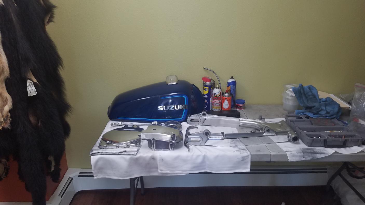

          I have just done aluminum clutch side cover, ignition cover, fork bottoms, swingarm, rear peg mounts, both rims, counter sprocket cover and handlebar top clamp plate. Just the flywheel cover to do for the aluminum bits. Also removed and polished alot of chrome bits back to shine from the surface rust look it started at.
          Some aluminum pieces I had to do some wet sanding stages to get rid of some imperfections from scratches etc then for polishing where I could I use a Finex material wheel on my angle grinder, smaller versions of material wheels from the local hobby shop made to work on my dremmel and some elbow/wrist power as well. I used Mothers, Blue Magic and green or white rouge as well as recently ordering some Autosol to give that a try for comparison. In the end with power buffer the rouge brought me the best shine, by hand the Blue Magic beat the others out....even the Autosol in my experiences.
