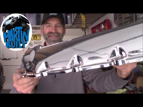

    This video shows a step by step process for polishing a large Dodge valve cover in magnesium, but the same principle would apply to any aluminum covers.
    How to get a chrome-like finish from raw magnesium. This video will also work for polishing aluminum. I'm using a set of valve covers from a 99-03 Dodge 4.7 In 04 Chrysler went to a Composite Plastic valve cover.

    awesome
    id have fastened the workpiece to table
    he should have weighed em before and after

          Originally posted by Cipher
          awesome
          Did you see the part when he had his lack of grounding hazard LOL?
            heck yes funny
            scary and funny
