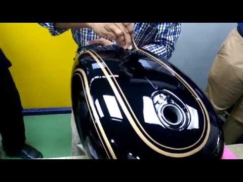

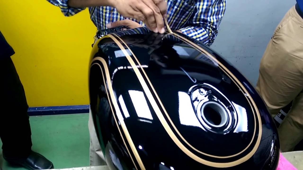

    'Tis a pity India's so far away, because the lad who pintripes the Enfield tanks would knock that out in his teabreak for norra lorra dosh.
    Didn't somebody post a video of that lad from India a few years ago doing the pinstripes? That was just incredible!

        Amazing talent. Check out the lady doing the BMW stripes, too. No measurements, nothing, just skilled eyes and hands. It takes me hours and hours to measure mask and spray stripes to accomplish what they do in just a few minutes by hand.
