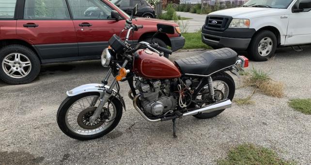

    Howdy everyone. I just got my first motorcycle! The guy before me had the carbs cleaned, but the thing doesn’t idle correctly. My mechanic says that there’s particulates from the tank that have clogged up the carb again. His remedy is to get a fuel filter before I run it again and then clear the carbs. To do that I’m going to take the air filter off, run it as high rev as I can get it, then put my hand over the intake. That’ll make a steering enough vacuum to suck all the nasty *@%^$*@%^$*@%^$*@%^$ out and it won’t be in my carb anymore! After that I plan on getting cone filters to throw on there instead of the box. I’ll post updates once I get to do this but if you guys have any advice on good ways to pull the intake or anything else let me know!
    Picture of my bike included as tax.
    Also, I’m looking into balancing the carbs once it can idle correctly and everything. If a build thread would be more reasonable I wouldn’t be opposed to that.
