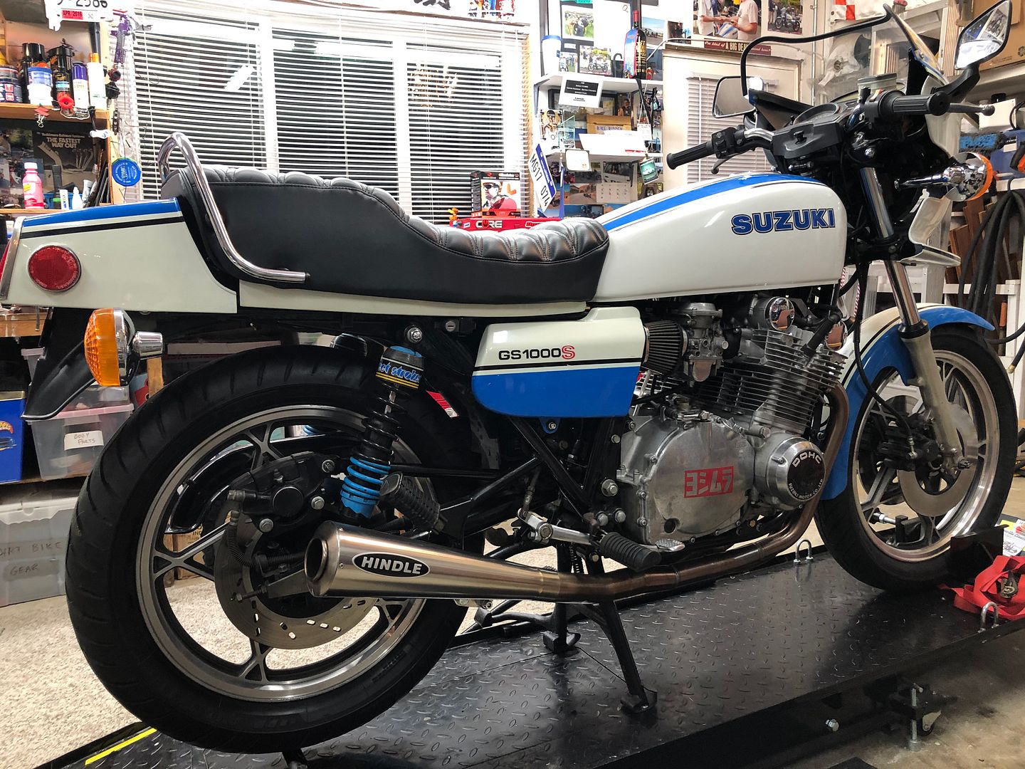

    If you consider performance Hindle makes the best Gs1000 pipe. 4 > 2 >1 for better mid range

              When I briefly had two cooley's the second one came with a Hindle...was very impressed with it....found some 79 gs1000L exhaust and put them on it when I sold it...still have the Hindle

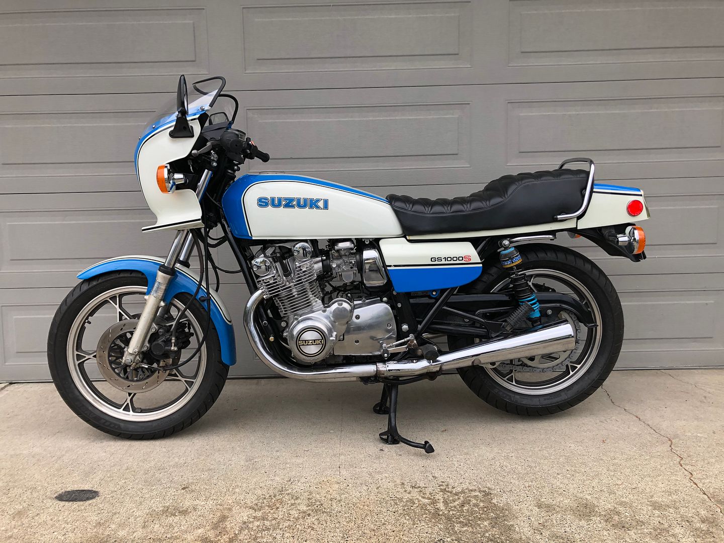

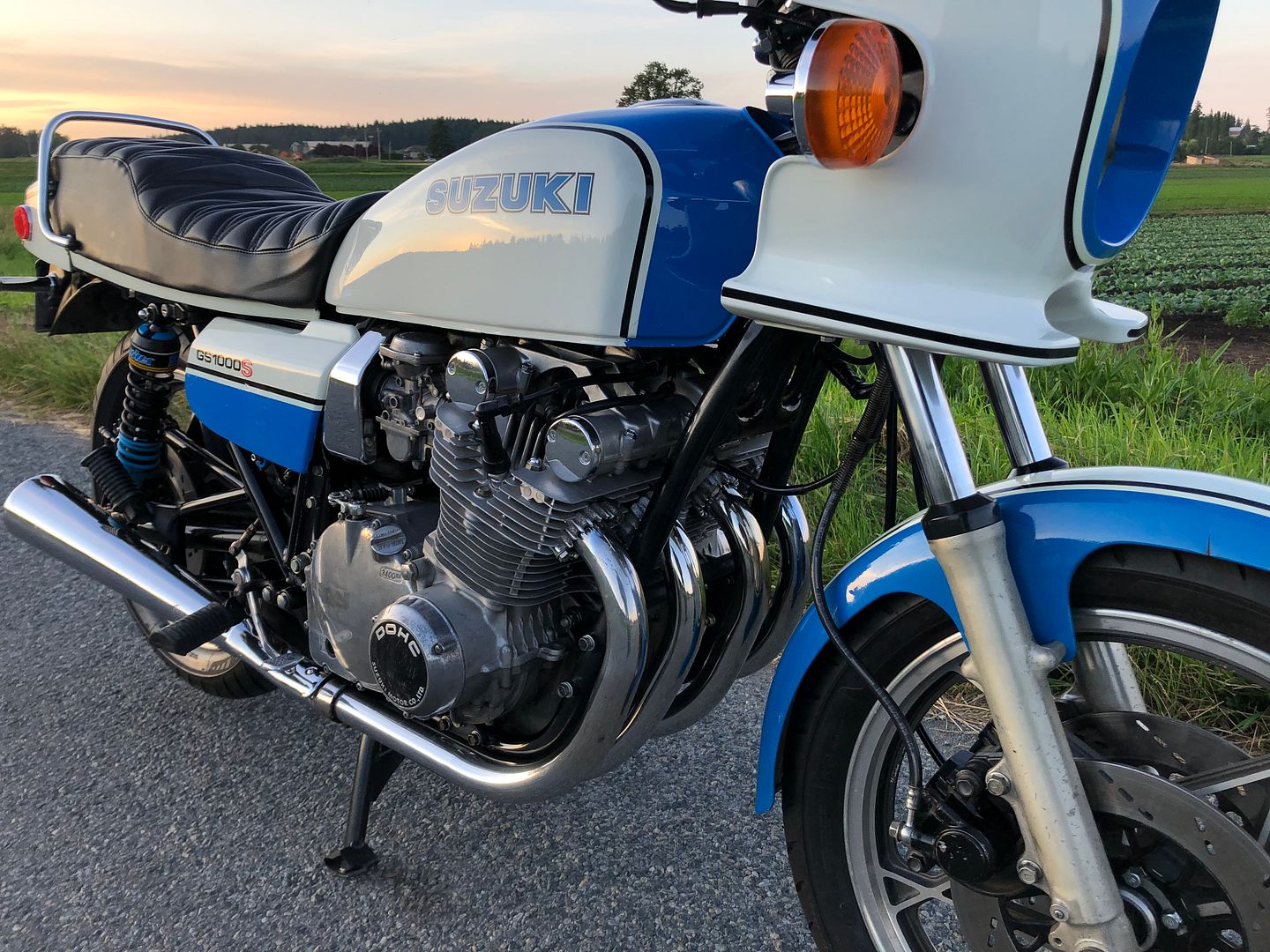

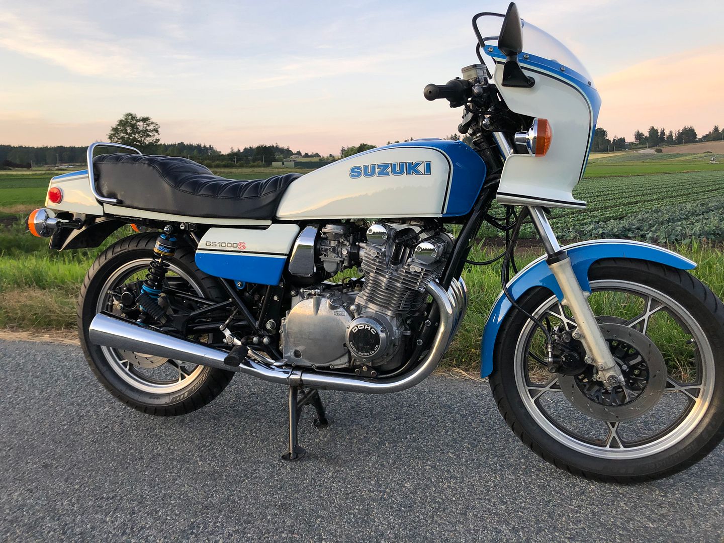

                For comparison to Trevor's photos, here is one of my old S's with the factory S pipes. A close eye is needed to notice any difference.

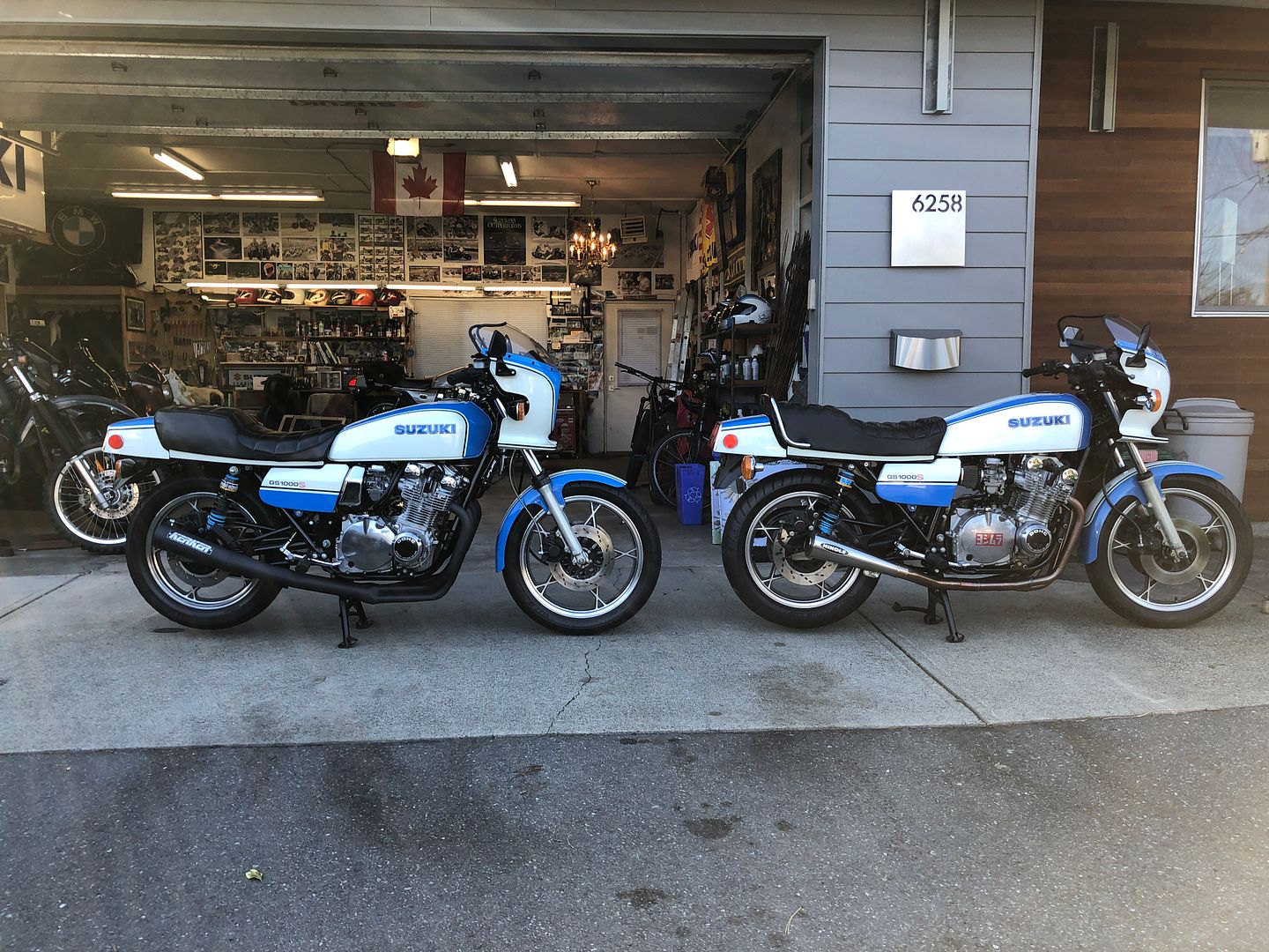

                      I'm looking at your brake pedals on the 2 Cooleys. One seems to be more rearward, but the other seems to have a non stock engine (clutch) cover. Both brake pedals stock?
                        • 18671
                        Originally posted by Rob S.
                        Trevor -
                        Hmmm good question. I never noticed. It’s just a yoshi decal I took off before selling.
                        I flipped that bike.

                            • 9387
                            Really? Oil sight windows look different sized.
