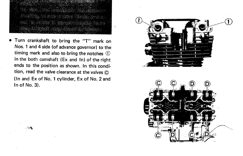

              Its really important that you measure the clearance between the tappet screws and valve stems with the cams in the correct position as per the workshop manual. There is clearance between the cam journals and the bearing beds and caps and correct positioning stops inaccurate measurement caused by the camshaft being unevenly loaded by the valve springs.
                I definitely did the order/position properly. I just haven't done it before so I'm still a little uncertain if I measured properly. Hard for me to believe they were off by as much as they were.
