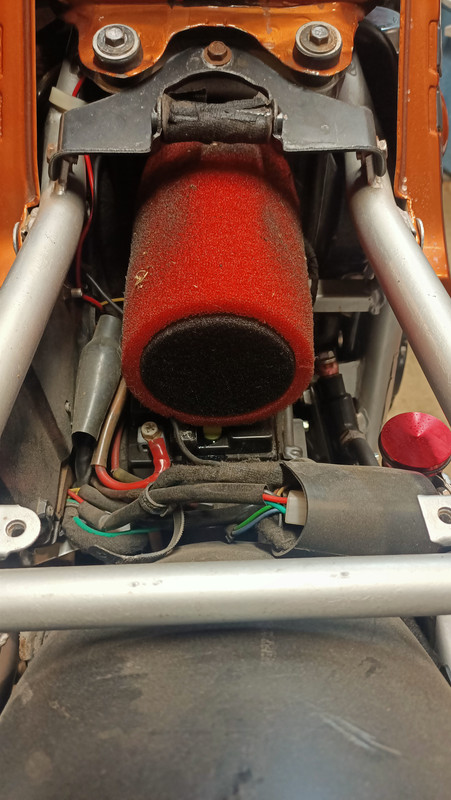

                    May be it's too rich? Have you plug chopped with fresh plugs while it's 'farting' around to ascertain what the combustion is like at this point? Stutter is usually a descriptor of a rich mix. Lean mixes surge, like your starting to run out of gas (because you are). As Nessism says in his signature "To measure is to know"
                    I say this because I run a large foam air filter in place of the airbox and a four into one and the pilot mixture and needle position is stock. The bike carburates beautifully. In fact the only re-jetting required was the main jet that is up 4 sizes.
                    Which makes sense if you think about it. Jetting is about adding the correct amount of fuel to the airflow inducted into the engine across the rpm range. Correct AFR = best combustion = best running/best power.
                    Air flows through the carburetor because the pressure the engine side of the carburetor is lower than atmospheric outside the air filter. At small throttle openings at which the pilot circuit is boss, the volume of air flowing through the air filter medium is small and slow, and the interference offered to that air flow by either the stock or an aftermarket air filter is negligible. So if airflow is the same, why would you need to add fuel?
                    Air flow through the induction system is limited by some form of restriction or another. Most of the time that restriction is the throttle. That's why its called a throttle. It throttles the air-flow. Where the exposed foam air filter pictured above flows more air than stock air box is at WFO throttle, when it offer less restriction than the the stock arrangement, and more fuel has to be added by way of larger main jets to attain the correct AFR. Ditto legal four-into-ones they only increase air flow at small rpm band/resonant frequency. Reduction of back pressure in an unbaffled pipe may require pilot circuit tuning, but generally its an adjustment of the fuel (pilot) screws.
                    Finally, the last bit of tuning head-scratching I had on the 750 above was pilot mixture screw. I had stutter/hiccup at about 1/8 throttle which was annoying as hell, especially when feeding in throttle from closed mid-corner. Because I hadn't found a reliable feedback process to judge the difference my screw adjustments were making -you can't practically adjust the screws when your riding. I was flying a bit blind. I followed numerous advice/tools and found that 'blip testing' worked. Essentially set all your pilot screws the same, warm the engine (go for a ride), set a steady idle with the idle stop screw and blip the throttle letting it snap shut under its springs. If the idle hangs or slowly returns its lean, if the revs drop below the idle you've set before stabilizing, or it stalls its rich. Adjust all screws in equal increments until the revs drop quickly to your set idle speed without deviation.
                    I discovered that i was way rich in the pilot mixture at 1.5 turns. The bike is now joy to ride and the screws are at about 7/8th of a turn from seated.
