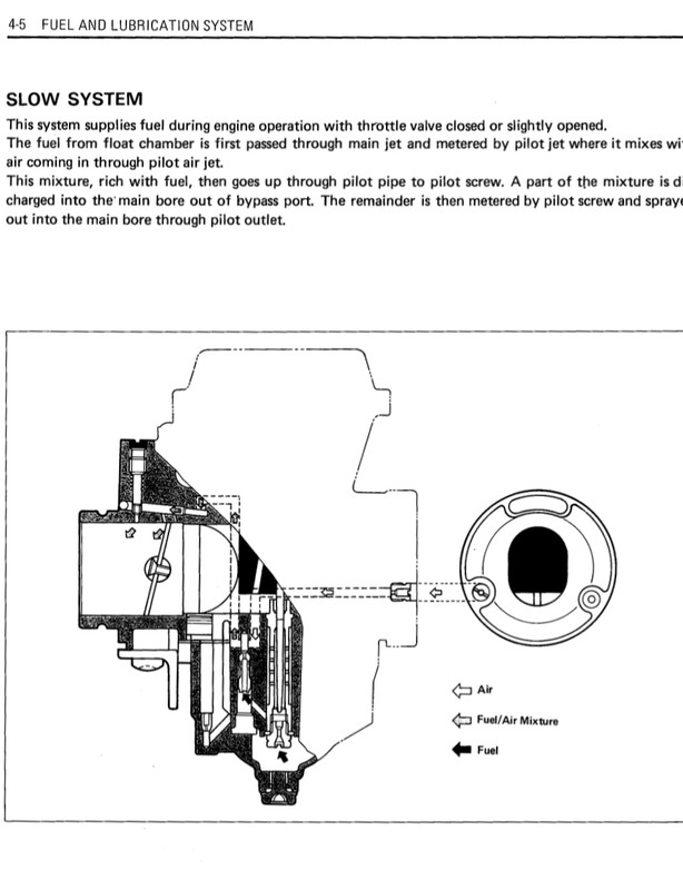

      Hanging idle is symptomatic of a lean idle mix. Air leaks make a mixture lean as it adds additional air. If the carb spray isn't changing the idle and you're sure it's not an air bleed, then it can only be an idle circuit issue. Lean = not enough fuel for the volume of air, so it may be fuel blockage in the pilot circuit. Clogged pilot jets? Clogged by-pass offices? Can you squirt carb cleaner through the pilot system to visually confirm the pathways are clear?
      The pilot jets in the Mikuni BS (I'm assuming here as you say 82). Have a small hole at the pointy end which is the main fuel path way into the pilot circuit you should be able to see daylight through them. The holes on the sides of the jets are air bleeds.
      Here's the official Suzuki diagram of pilot circuit fuel and air flow.
