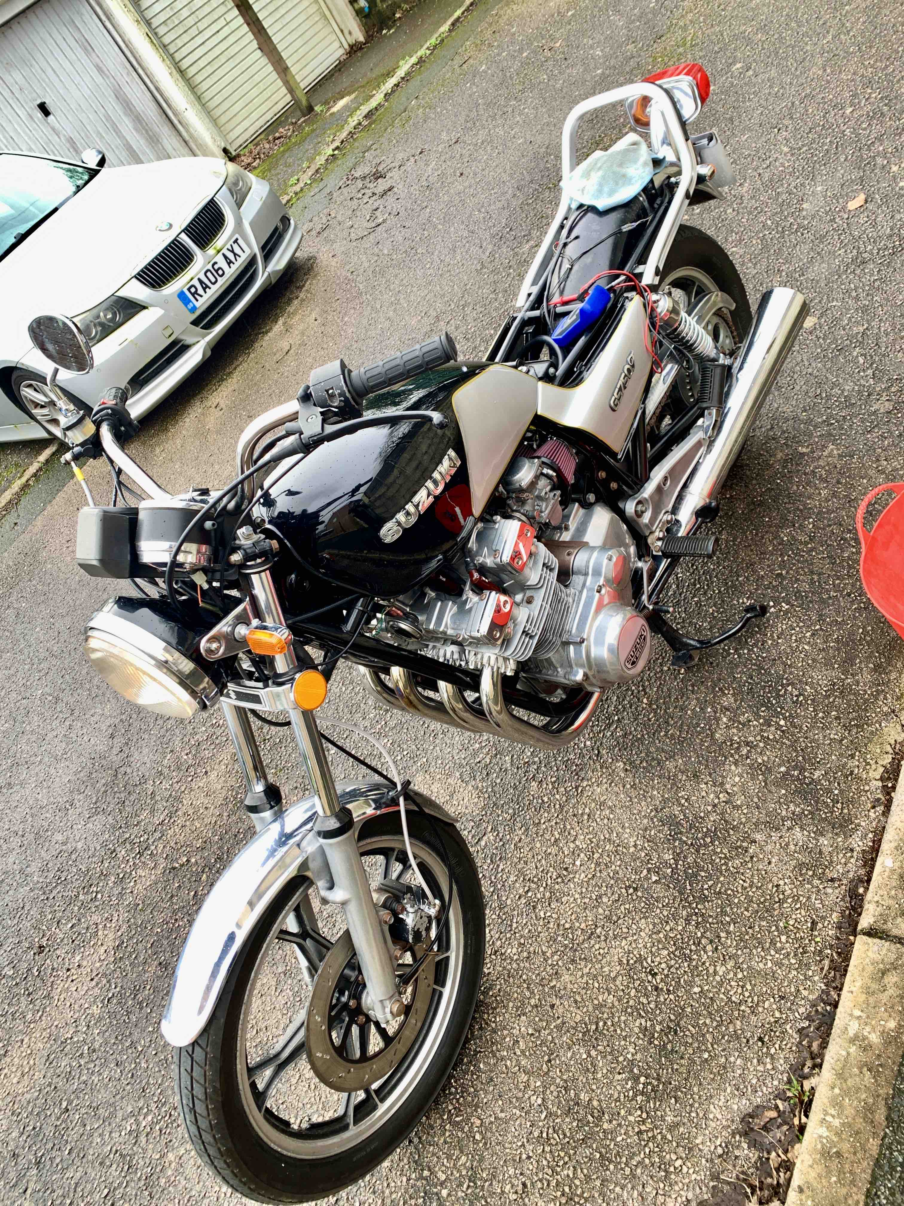

    Suzy has a flat spot.
    From idle to 1/4 throttle, she's a dream boat.
    But as soon as she hits 1/4 throttle, she bogs. If I keep twisting the throttle, she'll kinda get over it, but it ain't a pleasant experience.

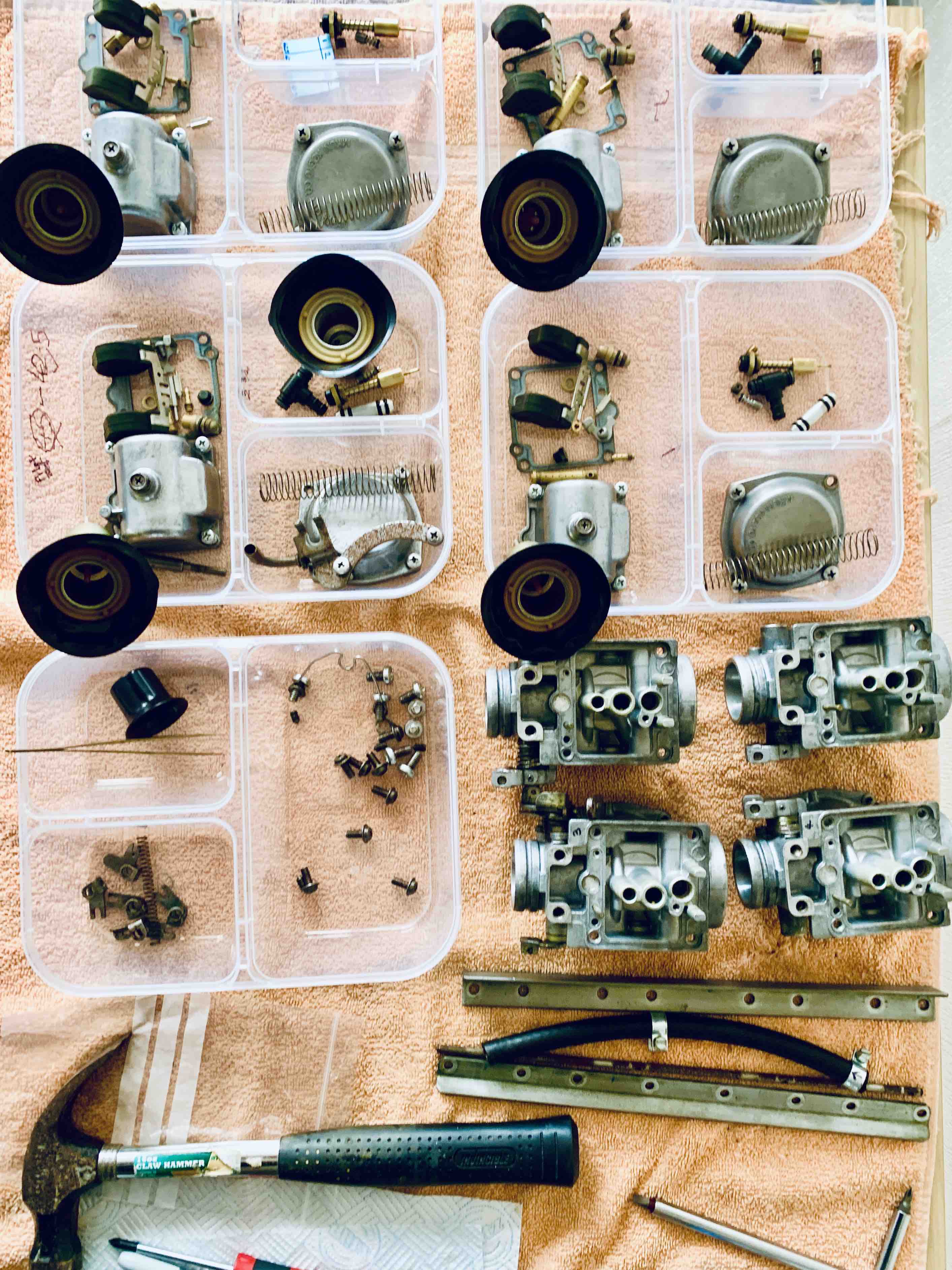

    In the spirit of starting with the 'low-hanging fruit' and building up from there, I'm in the process of stripping down and cleaning her carbs (again).
    I've got a couple of questions that will follow after this photograph.

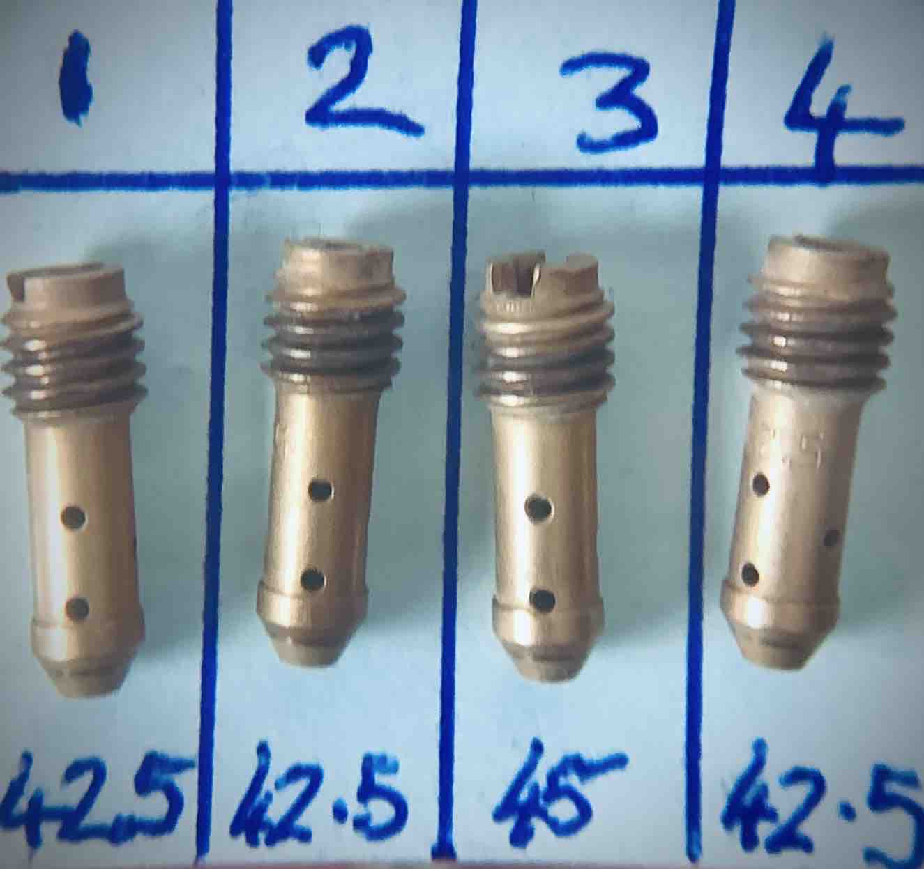

    Question 1: This time around, I've made sure to check everything. And that's when I noticed Carb 3 has a 45 Pilot Jet, yet Carbs 1,2 and 4 have 42.5. The factory setting is 42.5.
    Does anyone out there have a spare 42.5 Pilot Jet (OVERALL LENGTH = 14 mm. THREAD DIAMETER = 4.9 mm. 6 holes in shaft for a Mikuni BS32 (CV) Carburetor? I'm in the UK and either my GoogleFu is weak (possible) but I can't seem to source one from my usual sources - mainly cmsnl.com

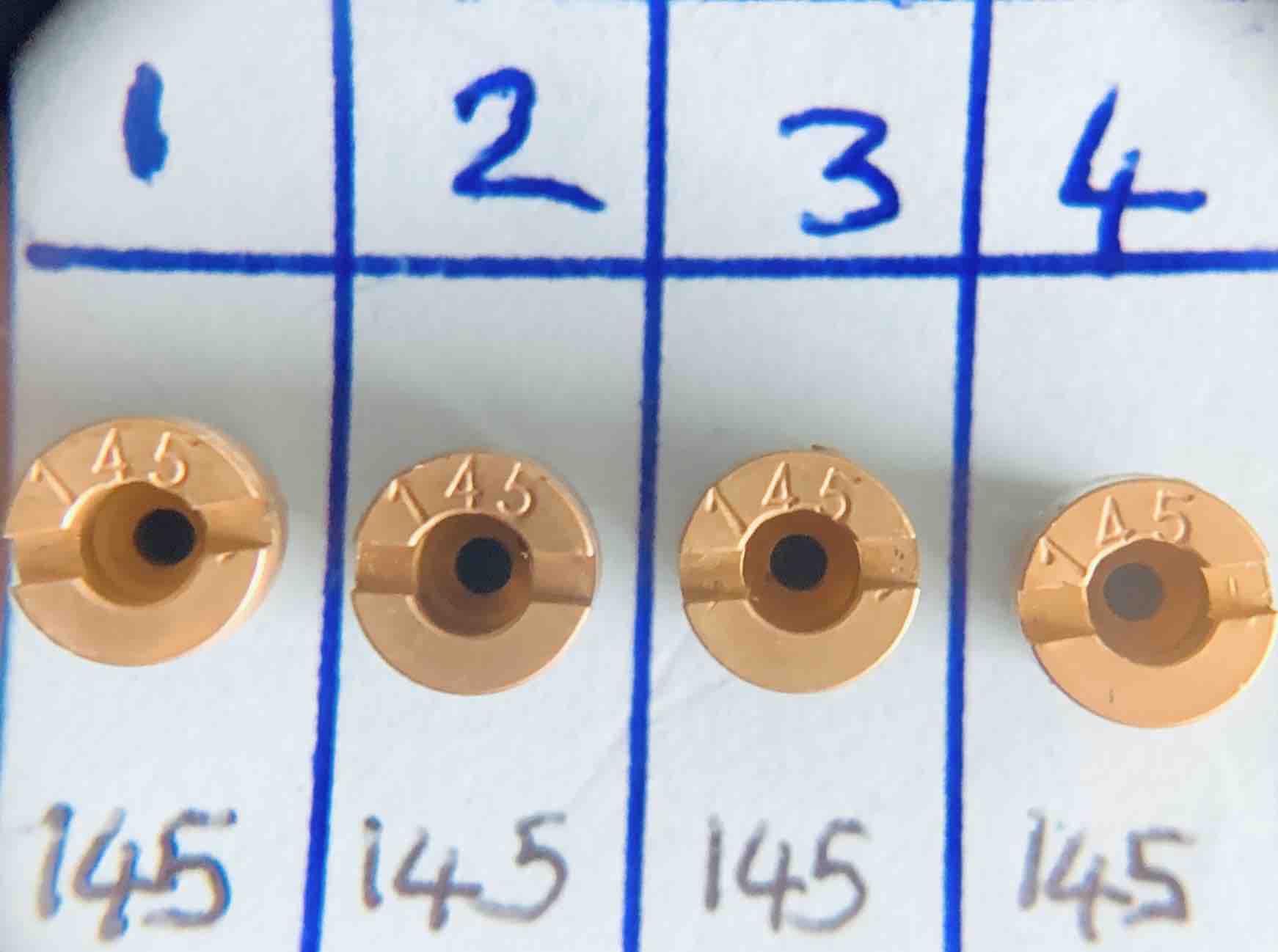

    Question 2: My Main Jets are all 145. But Factory settings call for 112.5 - Should I keep the 145's or replace with 112.5? Suzy now has an original exhaust instead of the noisy Delkevic 4 into 1 pipe she came with. But she still has pods. Granted they're K&N, but they're better than the one's she came with. Oh, and I've fitted Zed1015’s air correctors in the 4 O’clock position on each carb.

    Sorry just had a look through my jet stash (im in the UK), I only have a size 40 with bleed holes, I can only find 1 used item on ebay:
    as for your 1/4 bog this chart should help you out:

      Zed says to bump one size main over stock when using his air correction jets, so that suggests 115. I'd try those and see how things go

        Katana1074 - Thanks for the diagram. Once I get the pilot jet and main jet parts, I'll put her back together and see about my 1/4 throttle onwards bog. If it's still not fixed, looks like I'll be getting into the wonderful world of carb needles =)
        Nessism - Thank you. I didn't know that. I shall seek out 115's

            I know nothing about air corrector jets, but back in the day, pod filters, especially with the bigger oval K&N's the mains would need to be raised quite a bit, but not near 13 sizes. I'd guess maybe125 to 132.5 would have been close. The exhaust. will have way less effect on the jetting than the pods.... That being said, if ED says 115's with air corrector jets, that's probably a pretty good place to start.
              • 35808
              Dynojet used jets with a different numbering convention. I wonder if a kit was installed by some previous owner. That would explain the seemingly huge mains.
