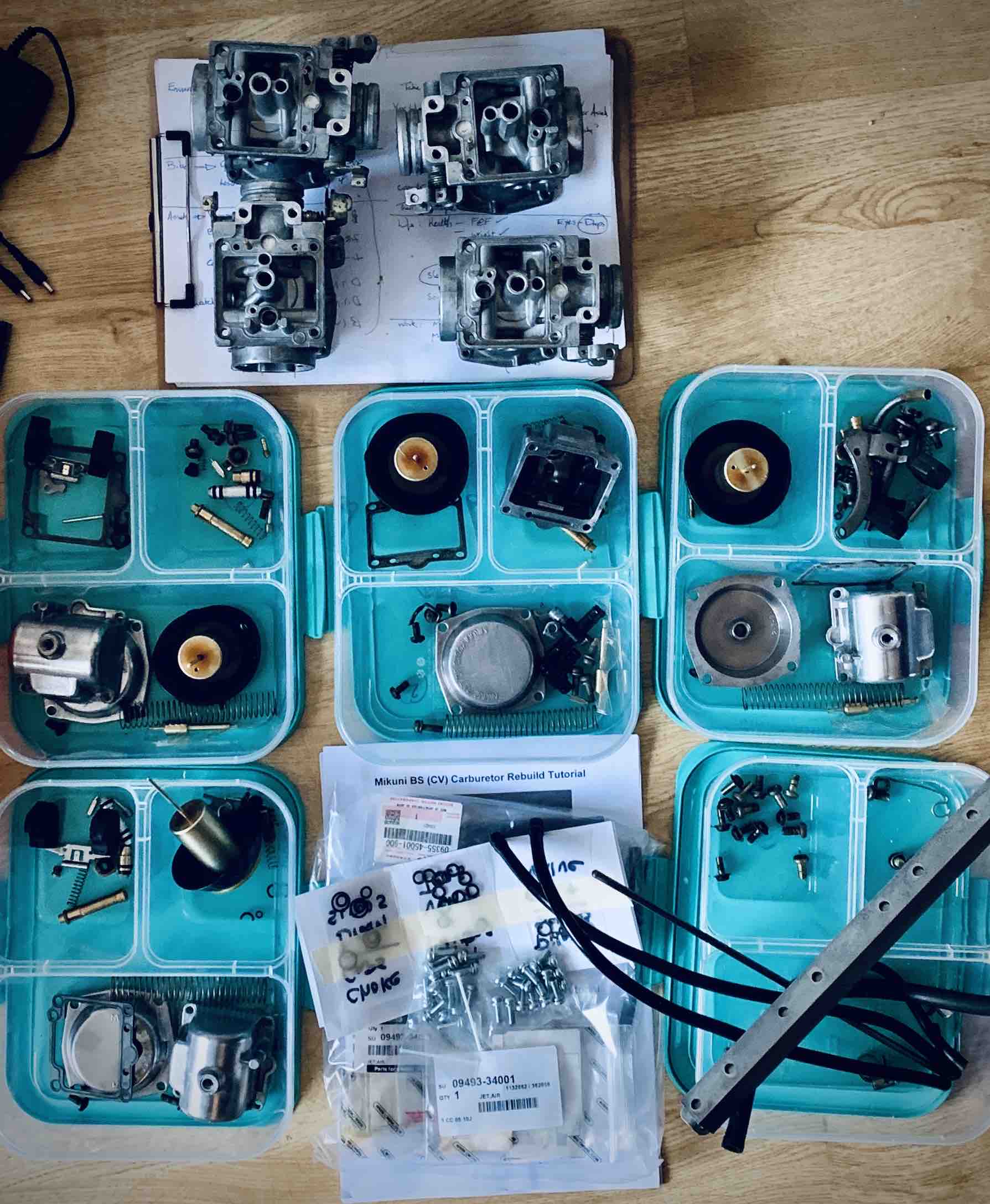

And I:
- Used Ed Ness’s excellent CV Carburetor Rebuild Tutorial to Strip the carbs down and clean them.
- Replaced all O-Rings using the kit from Nessim.
- Sent Choke plungers to Zed1015 for his Viton replacement seat treatment
- Fitted Zed1015’s air correctors in the 4 O’clock position on each carb
Oh, and followed everything in Ed Ness’s most excellent Mikuni BS (CV) Carburetor Rebuild Tutorial (Float heights, measuring float levels, Bench Sync etc).
Along the way I discovered a tear in carb diaphram #4 - Replaced.
I also discovered Carb #3 had a 45 pilot jet in it whilst the others had 42.5 - Replaced.
Main jets were 145, factory is 112.5. Was advised to go one size over so have fitted 115's.
