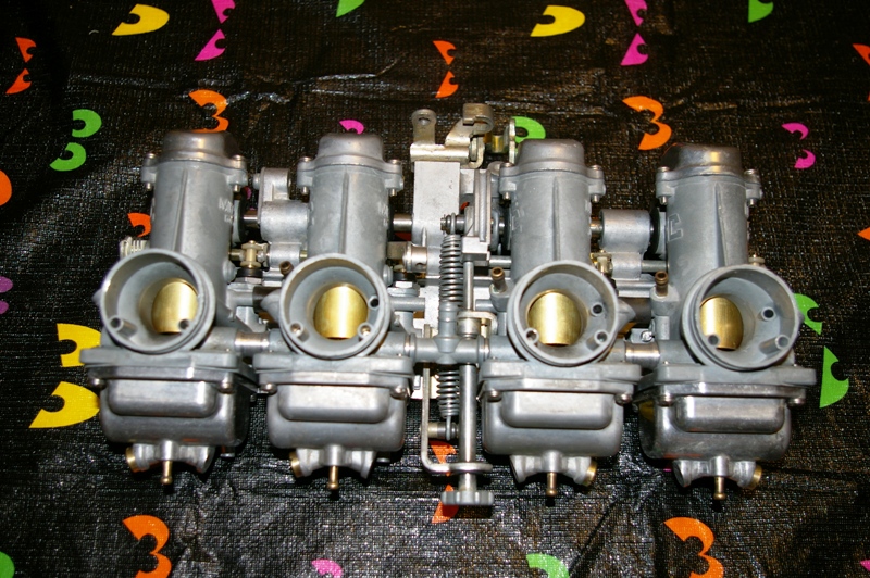

                        These are the carbs I did
                        Everything metal saw some dip time. Even the frame.. (dip it one end at a time)
                        Soak, pull em out, dunk in a bucket of water to get the dip off.. blow out with compressed air.. let dry.
