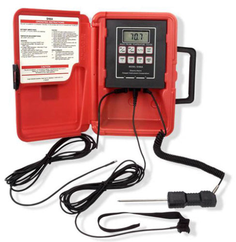

        Yeah, your finger..
        I use one of these.

          http://www.techinstrument.com/acatal...FQ0hnAodsgInDg
          HA!

              DONT use your finger. The temps of those pipes at the head is well over 1000 degrees. Your finger will be burnt before your brain even registers that it hurts. If you cant find a little digi surface temp thermometer, or dont want to spend the dough, use a spray bottle of water. Those pipes are hot enough at the head that the water will vaporize almost instantly. If one isnt, then its either cooler than the others, or cold. What colour was your plug in #4 anyway? If it was white, or no new colour at all, chances are you may need to richen that carb up a bit. If you've rebuilt your carbs, and set the mixture adjustment screws to 2.5 turns out, that is just a baseline, it may need adjusted in or out depending on whether its rich or lean. Also, to TRULY have the bike sucking and blowing nearly the same on all cylinders, you need to have your carbs synced properly, and your valves should all be adjusted if you havent already done that..

                I knew it was going to be hot and was going to make a joke about burning off my fingertip but... I started with the pipes quite cool and just let them warm up to "hot"... as in hot to the touch!
