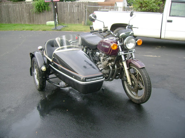

    I really did it this time. While I had the tank off for cleaning I decided to try to pop a pretty good size dent out with air I buckled to bottom of the tank out. I can probably beat it back into shape but it needs to be replaced.
    Any one know what years and models will fit this bike? It appears to be pretty big in capacity. I did a quick search on ebay but could find nothing close.
    I'm not against having to fab a mount but would like something close in length.

      Is that an 850 G or GL? Radically different tanks.
      Go here to look up the part number. Copy/paste it into the search here. Click on the "fits machines" link to see what models use the part.

            The '80 and '81 tanks from the 850G and 1000G should interchange with no problems. I currently have an '81 tank on my '80 850G.

              Furious D - 80-81 850G and 1000G use the same tank. Those are the only interchagable tanks across those models/years. The GL is smaller, more teardrop shape, and has two mounting holes by the seat whereas the G only has one. The G tank is 5.8 gallon and the GL I believe 3+ gallon. The bike frames are different too so you couldn't put a GL tank on a Gframe even if you wanted too.
              If you can't find anything on eBay, try the salvage yards like Stockers, or SS 2 Wheel, or the search engines like UNEEDAPART.COM, or MRCYCLEPARTS.COM. Problem here is these guys think they have gold and charge accordingly.
