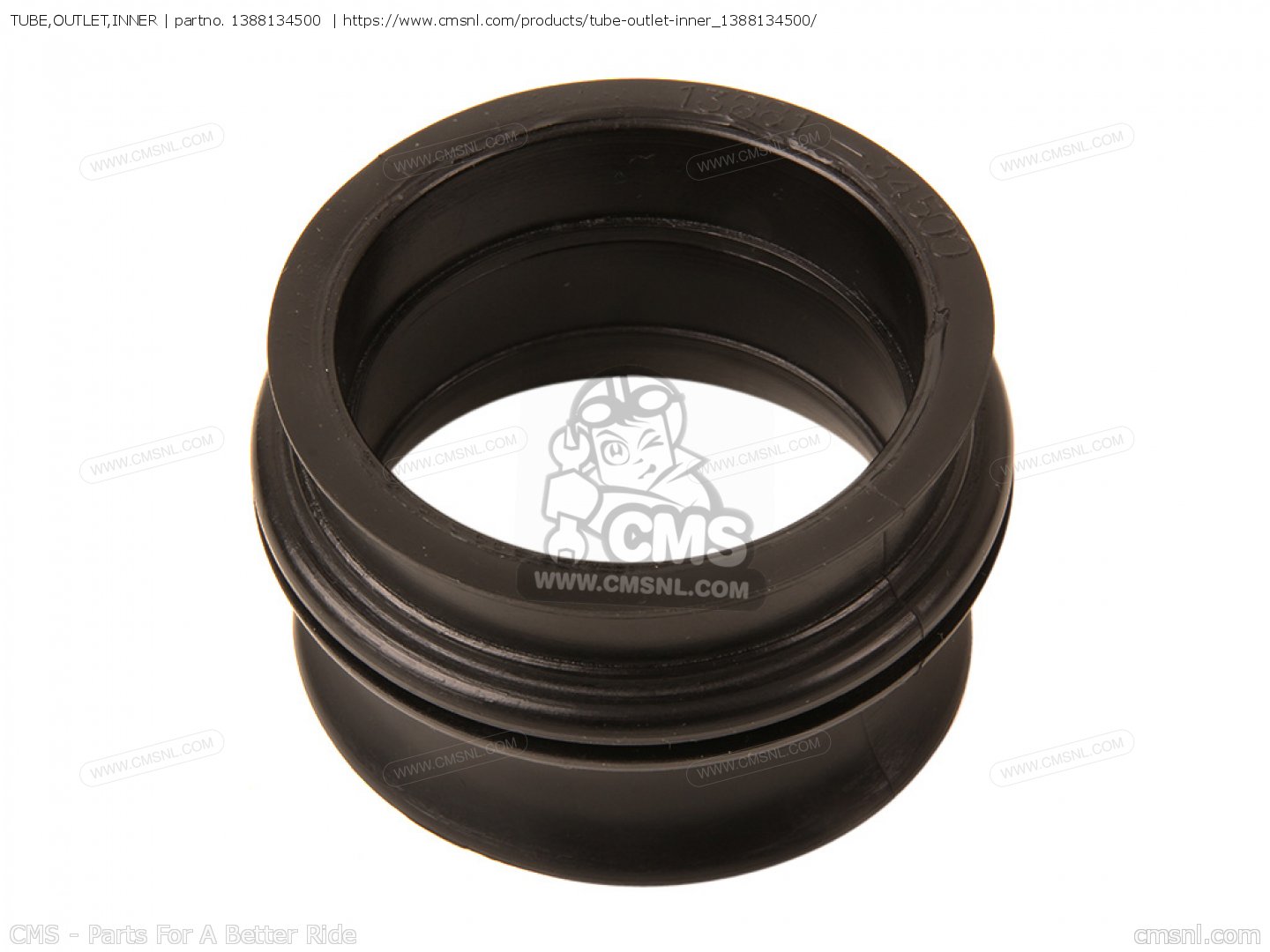

 Air box boot questionMy son purchased this 1982 GS650E to teach his wife how to ride. The PO said that it had been sitting 2 years(I think more like 5). Thanks to this forum, some help from Steve's valve adjustment spreadsheet and Basscliff's site, I have been able to get it running. Valves have been adjusted, Carbs have been cleaned(after sitting with gas in the bowls) and new o-rings installed(from cycle o-rings). New carb holder o-rings installed and petcock replaced. The problem I'm having is with the airbox boots. The 2 outer boots are fine. The boot for #2 carb is very stiff, but I can make it seal. The #3 restricted boot is torn and will not seal. This part is NLA for the GS650E. Does anyone know of a source or substitute for this other than replacing with pods? I would rather not have to re-jet the carbs, but will if I have to. The bike runs good, but I do have the hanging idle issue and an erratic idle. I can't synch the carbs without repairing this. Any help would be greatly appreciated.Tags: None

 Is there really that much difference between the inner and outer airbox boots? They don't seem like they would be that much different. It seems all the airbox boots for the GS650G are still available. Do you think those might work? I'm just thinking out loud here, I have no first hand knowledge with the 650E airbox.

 Thanks, I must have missed it on Ebay. Just purchased it. I had found a set of used boots for a GS650G, but they are not the same. This should get me going. Thanks again.
	 iambutterbean iambutterbean
 The 650G uses 2 inner and 2 outer boots with a slightly different airbox. The 650E has a restricted boot in the #3 position. I'm afraid without the restriction I might still have the idle issues. This is what the correct one looks like.
 Thanks to hampshirehog I was able to get this one off of Ebay. I must have missed it when I searched earlier. This forum and Bikecliff's site have made it possible to get this bike running again. I think I'll keep it after my daughter-in-law learns how to ride.
