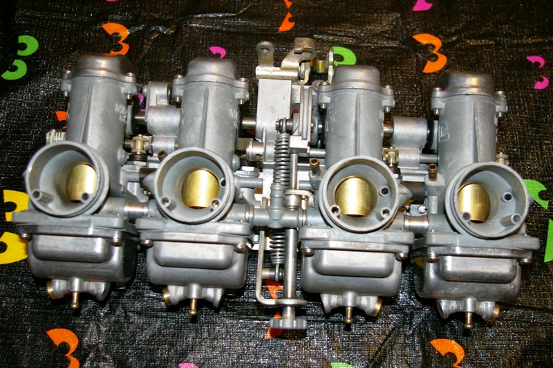

    Does anyone have photos of how the carb rack goes together? My memory card got corrupted somehow, so my photos of the tear down process are gone.
  • GateKeeper
    see if these help

          cable choke VM26 carbs (from 79 GS1000L) images 686-693
          I have the original 2000x3000 images on my home PC if you need bigger.

            Thanks guys. Between my 4 carbs, I've got 3 different configurations... Here's what I've got, and I'm not sure which carb goes where. I should have marked them but I thought I was smart with my fancy camera... I guess not.
            ANYWAY! Can anyone tell me which pic corresponds to which position?

                I could've sworn I added that when I added my location... Anyway, it's '79 550 w. the VM26 carbs.

                    Look at where the fuel nipples are, that will show you right, left & middle carbs. Thats what cell phone cameras are for

                      That's what I used to post the pics above. Ironically, I have $10k in photo gear but my phone has the worlds worst camera.
                      The nipples are what's got me confused actually. If you look at my pics above, one of them has no nipple, another has it closer to the "head side" of the carb, and the other 2 have the nipple closer to the "airbox side."

                          The 1-2-3-4 order is the hang up? Look into where the fuel flows between each carb. If there is no hole drilled in the left side, it's the #1 carb. No hole on the right side, #4. Holes on both sides, #2 and #3. #3 can be determined by the breather nipple actually being the one that provides vacuum for the petcock(assuming it's just like my 750's anyway...)
                          Pics to come shortly...

                            My camera has wifi, though that's irrelevent lol. I make a living with my camera. It's the proper tool for most jobs. I'm not going to touch it while I'm rebuilding carburetors, though and the memory card that works in that camera doesn't work in my point n shoot. The card from my point n shoot is corrupt now, which is why I used my phone for the pics that are a fwe posts back.
                            Anyway, back to the question of which one of the pics I posted above corresponds to which position on the bike. Any ideas?
