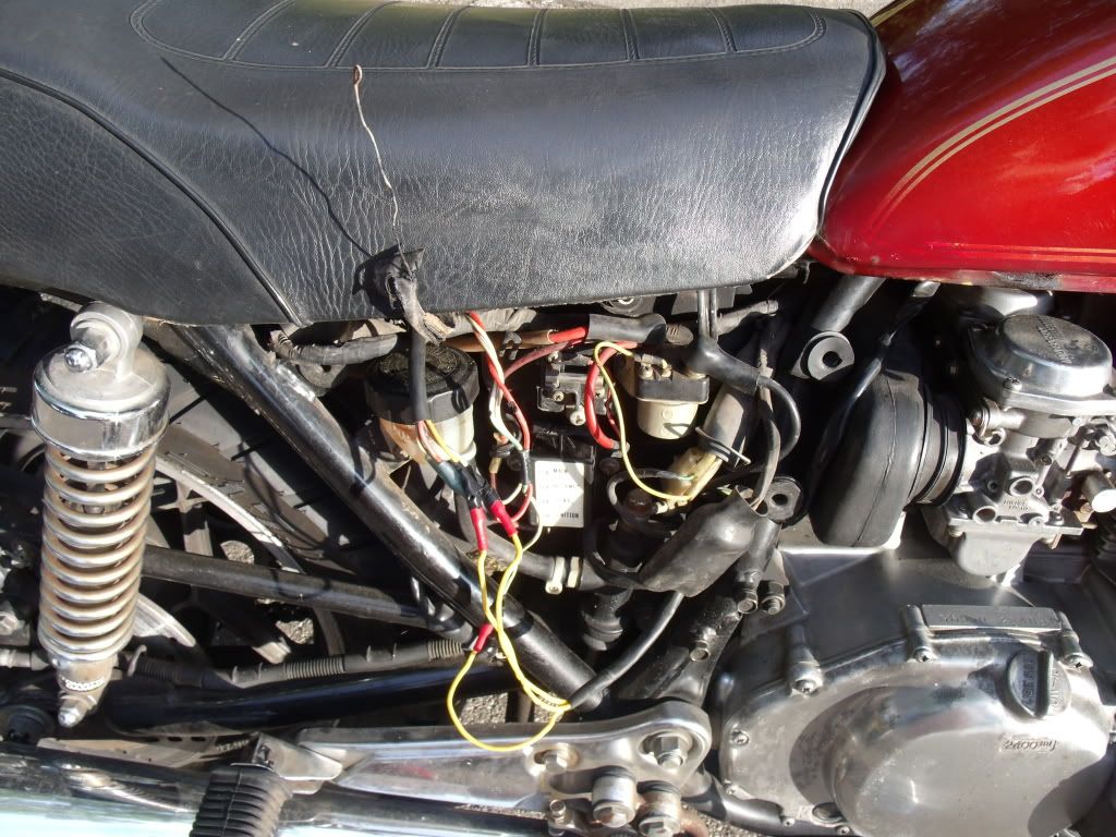

                        hey everyone, thanks for the replies, but I'm afraid I've made things worse.. I shorted something out. Removing the seat, the wire in the seat somehow came undone and started melting the sidecover, and throwing some nasty smoke. I rolled the bike outside as quickly as I could. Now when I turn the key, I get nothing, no lights, no nothing. You can see the wires that melted and were crossed in the photos. It looks like the red wire leads back the the rectifier, and the white leads down and into the engine case. I'm assuming this is bad, and won't be a cheap fix. Help?
                        • terrylee
                          Not sure if any of that would cause it not to start, but get a colored wiring diagram and see where those all go to. Should be one on Basscliff site. You need to rewire your r/r, red directly to battery pos. with in line fuse, neg. directly to ground on battery. And hook r/r directly to the stator and bypass all the old wiring harness which goes back through the front. Then test your charging system with the stator papers just to make sure your charging properly. terrylee
                            You have a wire in the seat?
                            Why?
                            • BassCliff
                              Hi,
                              Check your fuses. Clean up your wiring. That looks like charging system wiring that is overheating and badly kludged together. Use this diagram to properly wire your stator and r/r together. Go through the maintenance lists in your "mega-welcome" and become familiar with maintaining your bike. Use the guides on my website to familiarize yourself with all the necessary procedures. It's an old bike an your must learn how to keep it running properly.
