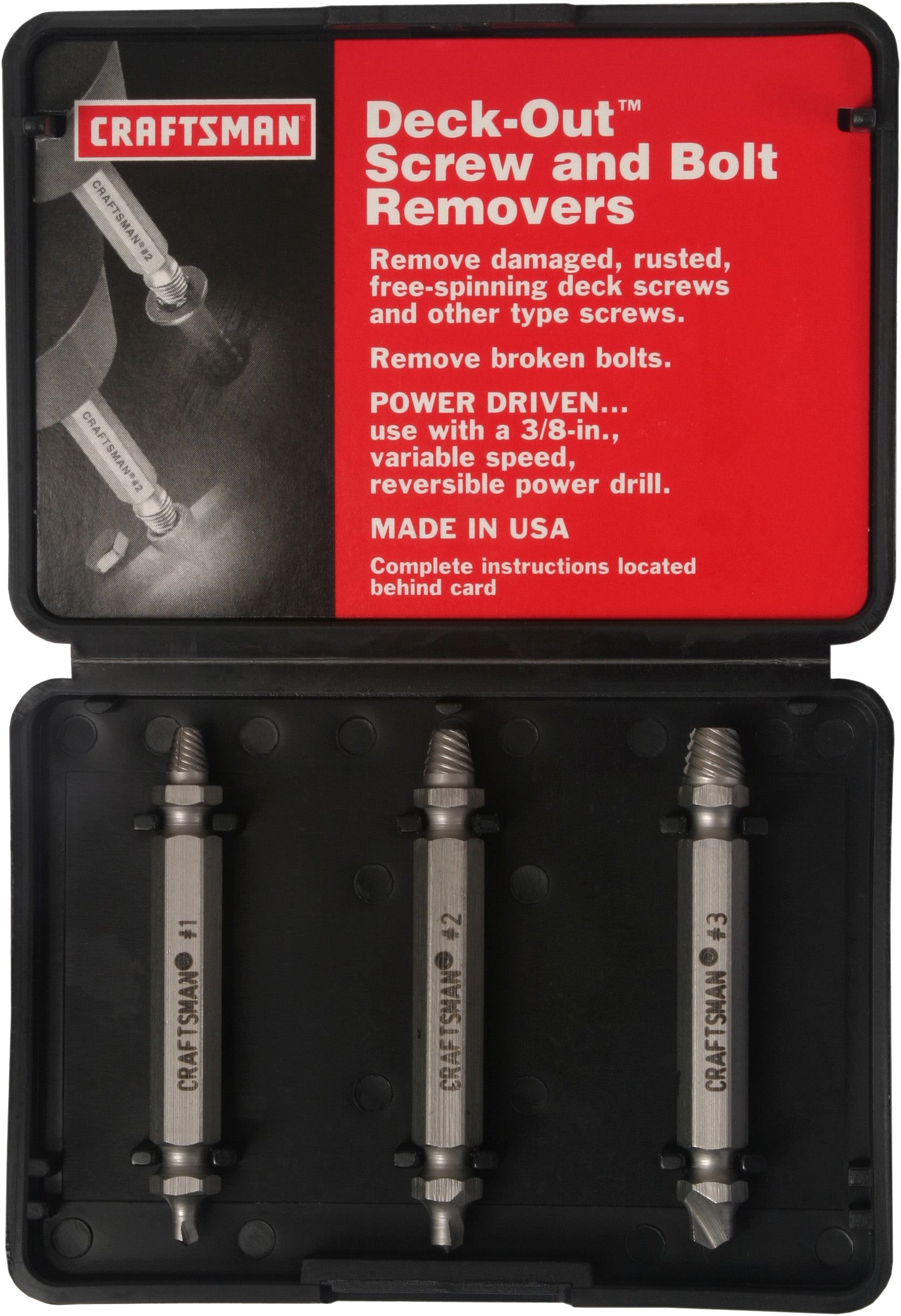

    I suggest you look to your local Sears Hardware and get a set of Craftsmen Deck Out screw & bolt removers. About $20. They fit in your drill and run in reverse. You use the appropriate size tool and 1 end is a flatened like bit that forms an indentation into the top of the fastener..then you flip it over and the reverse therads grab the fastener and -zip - out it comes to be tossed away...
    No risk of IMPACT to crack or damage other parts.....and it works just fine as I can attest having used it on several fasteners over several bikes I have refreshed these past couple of years...

            All I know is that this tool set has not failed me yet, and gotten out 2 screws that were stuck beyond any other resource ...including an attempt to use the impact driver.
            In the interest of disclosure ..The carb bodies are more fragile than I would like to hammer on regardless of their composition .
              An impact driver requires its own zen. I'll grant that in the wrong hands it is more destructive than helpful. However i'm sure the same can be said for the extractor tool.
