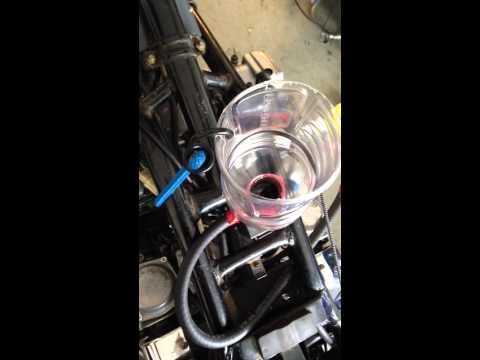

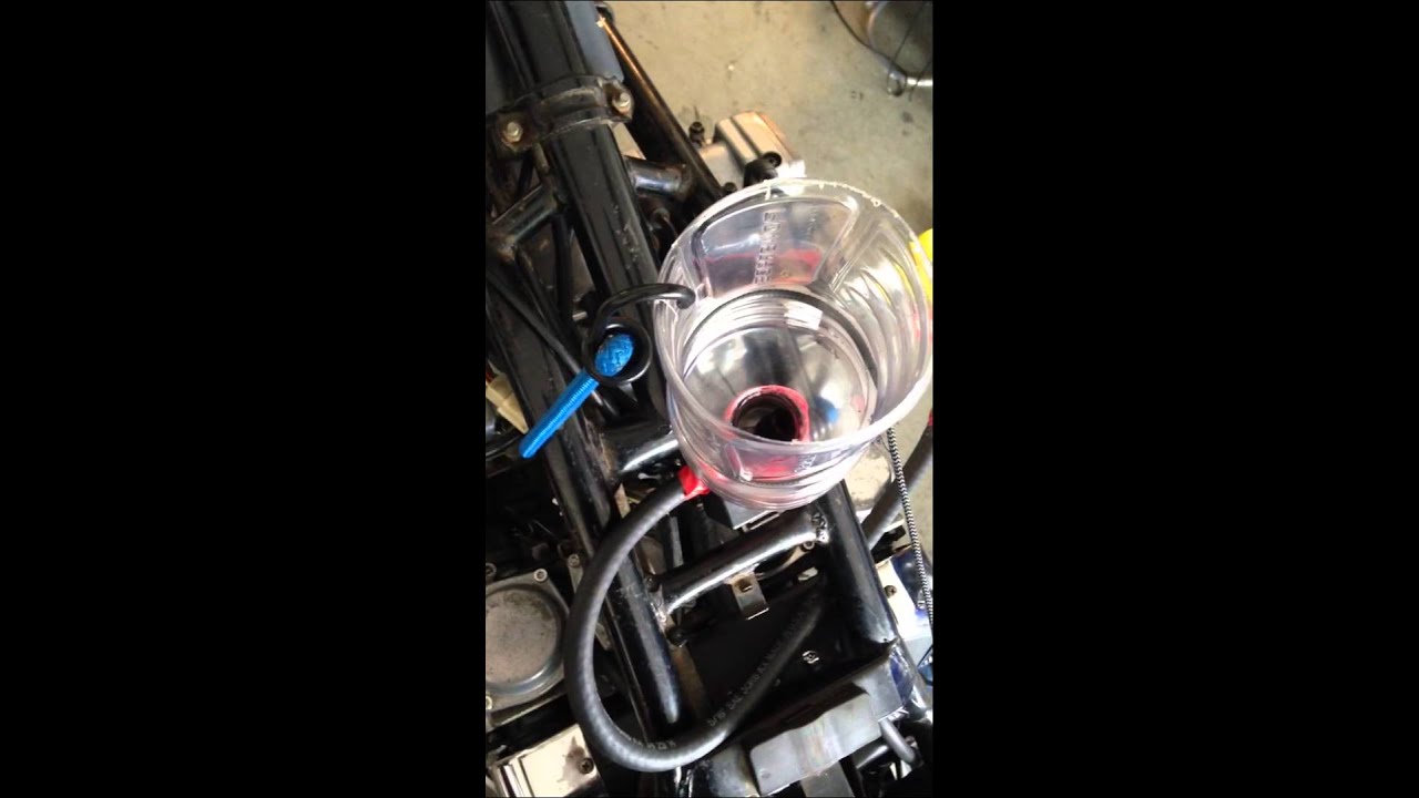

                              • Anthony
                                #45
                                Okay so I just got done messing around with my bike some more. After plugging the vacuum line, it started right up, but it still flooded, and only ran for about 10 seconds, then a loud bang happened. This happened twice, except the second run lasted about a minute or two, which I did record and am uploading to YouTube now. Here are the spark plugs after it's first run of the day, and were perfectly clean before: http://imgur.com/a/vNDI1
                                Here is the video I recorded of everything I was doing and my setup (sorry for the vertical video ):
                                So can anyone help me out now that I provided these things?
