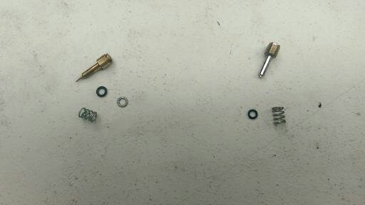

    Ok..so I've had idle problems from the beginning but really how long are YOU at idle... but after my trip around the west and comparing notes with other riders I figured I wasted 100's of dollars in gas during this trip at about 30-33mpg (sometimes way worse but never better). So I started reading about carbs on BASSCLIFF'S website. As usual I started where I thought I needed to look rather than taking time to read the whole thing on the various Carb articles. So after I ordered the o ring kit from Robert Barr's cycleoring site I finally looked to see how to adjust idle mixture... and lo and behold I found a broken stainless steel pilot screw (the other 3 were brass and I'm assuming original) I tried to upload a picture but i'm still learning this forum. I looked at the manufacturer's website and they want 24.95 plus shipping for the needle valve... a bit much in my opinion but I thought I would take a ride out to the bone yard to see what he's going to have laying around.
    I know I'm going to rebuild these now..but would like to have all the parts I KNOW are going to be replaced before I tear too much apart.

    Yes, that's poor mileage, so best to clean carbs properly( following the tutorial) replace o-rings and inspect jet sizes in case some PO got ambitious. That's the idle mixture screw- usually not shown on parts fiches, where did you see it listed? Don't confuse it with pilot jet needle. Boneyard would be good place to look , especially since you have 3 good ones.

      If you need a pilot screw, why were you pricing needle valves?
      I have some extras. PM your address to me, maybe toss a couple bucks in my PayPal account to cover the shipping and you will have one in a few days.

        From my car carburetor days.. a needle valve is a needle valve. The pilot screw sure LOOKS like a needle valve to me.. (it's needle shaped.. at least 3 out of the four are...) I'm going to tear down all the carbs as I've got the o ring pack from Robert now and see what else I'm going to need... with the job the PO did on this one little thing...I can't wait to see how he re-jetted the main jets... I've got the DynoJet pack that he used.. but it looks like it's missing one original(?) #115 jet.... I'll take you up on the PayPal thing ... Thanks...

          It is my understanding that in the case of our bikes, the term "needle valve" refers to the float valve that lets the gas into the float bowl.
          I could be wrong (again), and it might just be a matter of terminology.
          What you have shown has been known by many terms as well, including "mixture adjustment screw", "air screw" and "fuel screw". Of these, only "Mixture adjustment screw" would be anywhere near accurate, but Suzuki calls it the "pilot screw".

                After full disassembly it seems that the only part that needs replacement is that pilot screw. Sent you PM Steve. Thanks again for that offer.
