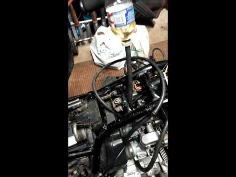

And by the way, this whole time I have been using a bottle with gas in it. The cap was drilled to fit the fuel line and the vacuum is operated by the bottle being sealed. The tank is off and set aside so this has no possible way of being the petcock. Also I am NOT running seafoam currently.

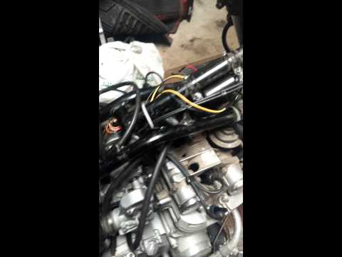

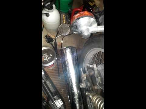

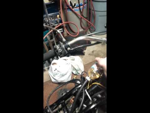

The bike will run for a while now, it may even be able to be driven. Although the rear brake needs to be serviced, needs both tires, and needs a headlight. Here are some pics and videos for the update, it still dies every now and then, and Im not completely sure why, and the tachometer does not work. I have set the air/fuel mixture screws at 1.25 turns out from gentle bottom, the fuel pilot screws on the bottom to 3/4 out from gentle bottom, the floats adjusted to 0.914" to 0.918" on each.
Choke has to be all the way open at all times, any lower adjustments and the bike will die right away.
Here is the rigged up "gas tank" with the 'capped' vacuum line that goes to petcock.
Heres the videos. Read the descriptions on them for info.
Link & Desc. https://www.youtube.com/watch?v=3fIs...ature=youtu.be
Link & Desc. https://www.youtube.com/watch?v=29PUuonf0Gc&feature=youtu.be
Link & Desc. https://www.youtube.com/watch?v=rsulCJiWIfA&feature=youtu.be
Link & Desc. https://www.youtube.com/watch?v=9prT...ature=youtu.beLast edited by Guest; 09-19-2015, 02:02 AM.

It's good that it's running, it mainly looked like fuel starvation - crap in the tank, faulty/blocked petcock plus the fuel filter would not be helping.
You will have an issue with that bottle you have rigged if I am not mistaken - there is no breather on the bottle which means a vacuum will build up in the bottle preventing the proper fuel flow from happening.
