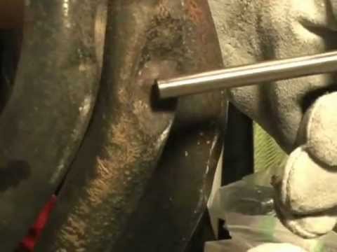

            Chuck, if you do end up using the wrap, here's a nice video on the correct procedure.
            David.
