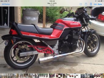

    So I just recently acquired a new '79 GS 750e (after always having had a '79 550L)!
    I purchased it already podded with a 4-1 V&H exhaust; I noticed that the pipes were bluing, but didn't think much of it. Well, I was riding the other day and it was popping more than usual and had lag in the throttle. I figure it's time to re-jet. So, that being said, I don't know what these carbs are. I know that they are Mikuni, thought that a '79 750e ran on VM22's, and I couldn't find what they were in the owner's manual.
    That out of the way now, let's talk jets. I understand that each bike is different and have done my reading. Going along with one of the charts that was provided here by another member, I understand that the pilot jets are 15's and the mains (I think, can't remember) are 100's. I was going to start at 117.5 and go with 17.5 pilots although some people have recommended sticking with factory pilots. Any thoughts? Recommendations? I went to Z1 Enterprises to look around at jets, but again, don't know exactly which carbs are on the bike so I need some help before the trial and error of jets.

    They look like stock 26mm.
    Measure the inside diameter on the engine side.
    Looking at the stain on the float which could indicate that the carbs have been neglected, i would do a complete carb tear down, clean and o-ring replacement before i started messing with the jets.

        What main jets are in it now, which jet needle and where is the clip?
        Nice looking bike by the way.
