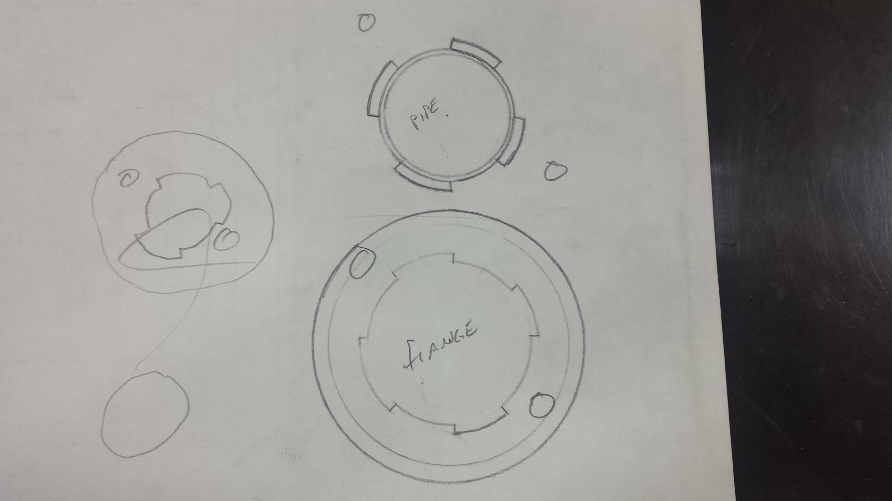

            Here's a couple of my ideas. Anyone can chime in and critique this because I don't know how practical it would be. One idea is expressed in the thumbnail and the other is to bore the clamp out to receive a two piece keeper somewhat like #1 and #4.
              The thumbnail's a neat idea!
              I'm not sure about the structural integrity however, and I have no idea about the forces exerted on these parts, and about the seal. I'm going to take off the exhaust off the second bike to get a better overview.
